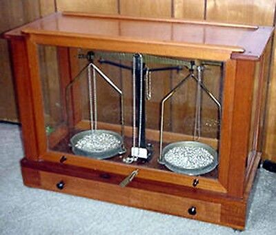

I have thought about buying a beam scale, as a backup to my Sartorius. I always thought it would be nice too protect and display the scale in a wood and glass train display case. They can be found online for $35-$60 and they offer custom sizes to.
Always thought the old beam scales of old that resided in those glass cases were very cool. Sort of a modern turn on that concept. Would love to find a nice cabinet without the scale like the one below. This way you could use the scale in the case as well to protect from air movement.
But something like this would do. Although I found many designs and sizes. https://www.etsy.com/listing/559421752/124-scale-golden-oak-model-car-case-by?ref=related-2
