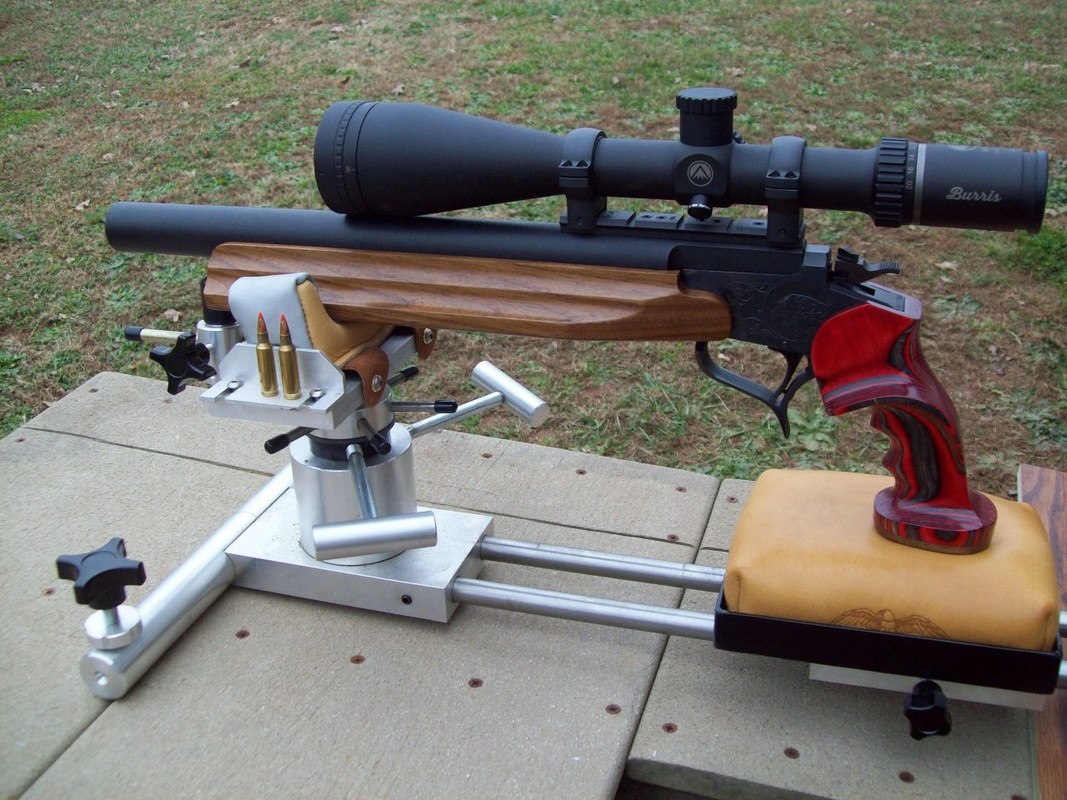

I prefer this setup. Rest maker is sadly no longer with us, but they can be had on the secondary market occasionally. I believe the pictured rest was one of the last He made. It is called a Fuzz Rest and also comes in a steel version.
Pistol has changed a little over the years. It now has a Flatside frame and a Leupold Scope. It weighs about 10 pounds and you can watch the hits through the scope.
