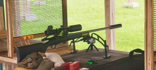

I shot mine this week as well: Lapua brass, Berger 52s, and 20.5 of H4198 out of a 13tw bartlein, and it's shooting into the. 3s & 4s without really trying. I know it can shoot better. I think I need a stiffer stock and I decided to sort my 222 brass for the first time ever after the range visit, so that should hopefully tighten things up next outing.
