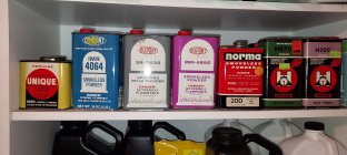

Looking good. Purchased maybe 1964
Raise ya few
This 4064 can is really strange...especially the spout
