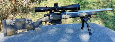

I bought the Athlon Ares Gen 3 4.5-27x50 for my Bergara B14R build.
I have shot the shit out of it & have zero qualms over the choice. Tracking & RTZ has been perfect for several thousand rounds out to 400 yards.
