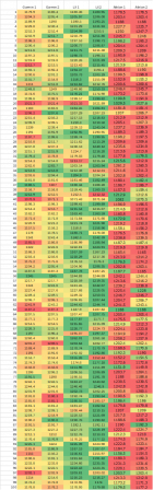

A) Relative offsets appear to persist between brands - applying a heat map for which units read faster vs. slower for each shot, a regular trend appeared:
--> One or both of the LabRadar LX's represented 90 of the fastest shots out of 100, and only ONE out of 100 shots did a LabRadar LX represent the slowest reading for any shot (including ties).
--> One or both of the Athlon untis represented the SLOWEST velocity reading for 89 out of 100 shots, and only represented 10 of the fastest readings (including ties).
--> One or both of the Garmins represented mid-range readings between the other brands 85 out of 100 shots, only representing the fastest shots for 5 out of 100 (including ties), and only represented the slowest readings 10 times out of 100 shots.
So 90% of the time, the LX was faster than the other two brands, and 89% of the time the Athlon was slower than the other two brands. The LX's averaged 0.8fps faster than the Garmins, which averaged 1.2fps faster than the Athlons. The average spread between all 6 units was 3.5fps, with the worst gap between all chronograph readings at 11.1fps, tailing quickly down to 8.2fps for the second largest gap, then 6.4, 6.2, and 6.2fps for the top 5 largest gaps. 80% of shots were less than 4.2fps for all readings.
**Nobody really needs to read all of this, other than to demonstrate the heat map, visually. The Left two columns are the 2 Garmins, middle two columns are the LabRadar LX's, predominantly green, representing the fastest readings for each shot, and the right two columns are the Athlons, predominantly red, representing the slowest readings for each shot.**

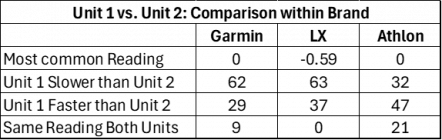

B) Within each brand, consistency is very good for all 3 brands, but for THIS test, best in the Garmin. In this 100rnd rimfire test, I saw an average of 0.54fps difference between the 2 Garmin units for each shot, with never more than 1.9fps between the two Garmins. The Average difference between the two LabRadar LX's was 0.83fps, with no more than 3.9fps between the two LX's. The average difference between the two Athlons for 100rnds was 1.07fps, with no more than 6.5fps between the two Athlons for any of the 100 shots. In this particular circumstance, the LabRadar was roughly 50% more variable between two units than were the 2 Garmin units, and the 2 Athlons varied from one another ALMOST twice as much as the Garmins. However, given all of these units have a stated precision of +/-0.1%, which for this ammo would be approximately +/-1.2fps, all 3 brands averaged within the expected precision (Garmin was the only unit which stayed within that window, but all averaged within the expectation). This is simply the consistency between two units of each brand - based on this N=2 test, Garmins may be more consistent in reading from one unit to another than the other two brands.
Less decisively, but similarly to the offset between brands, there was a relatively common offset expected between the two units of each brand. One Garmin displayed faster than the other slightly more than twice as often, and the two only agreed for the same exact reading 9% of the time. The LX's shared a relatively similar ratio - with one unit displaying faster than the other 63% of shots and only slower 37% of the time; however, because the LX's report velocity to the nearest 1/100th rather than 1/10th fps, there were no instances where the LX's agreed exactly on the same speed. The 2 Athlon units agreed on the same speed 21 out of the 100 shots, with one of the units being faster than the other for 47 shots, and only slower for 32 shots - so the Athlons were slightly more even on high/low compared to one another than the other two brands.
