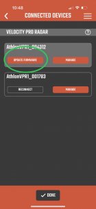

My version is 1.40.61 and the app says no updates available.
That’s my version as well. I don’t even see where in the app it says that no updates are available. Where is that? Don’t think Varminterror would have said one was available if it wasn’t. Pretty well confused at present.

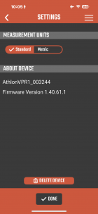

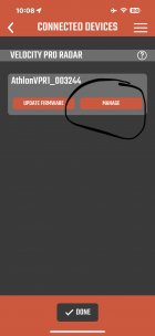

Third photo, hit update. If there is no update available a white rectangle will temporarily pop up at the bottom of the screen and say “no new version”.

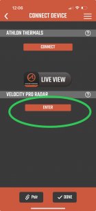

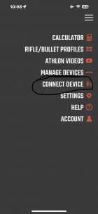

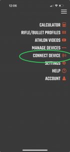

To update firmware (iOS)

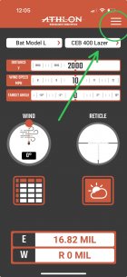

Open the app, which should start at the ballistic calculator landing screen.
Click the 3 lines in the top left corner to open the function menu and select “connect device”.

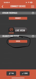

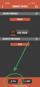

If you have not connected previously to a Velocity Pro Chronograph, then you will select “pairing” from the “Connect Device” screen
You will have to enter your phone settings app (grey gear) and Bluetooth settings, then connect Bluetooth to your respective Velocity Pro Chronograph.
If you have previously connected to a Velocity Pro Chronograph, then select “Velocity Pro Radar” in the device menu

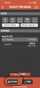

Once you have entered the Device page, you will see your available Chronographs, and under each will be two control links, “update firmware” (if the Chronograph isn’t connected, this box will say “reconnect”) or “manage.” When no firmware update is available, clicking to update will say “no update available.” Clicking “manage” will take you into your device where you can sync sessions and review old sessions.

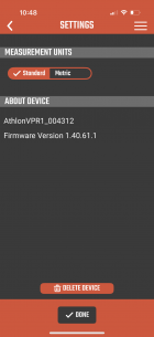

In the Manage tab, you can also check which firmware version your device has by clicking “settings” at the bottom left
Which will display the current firmware version, as I posted above.

The app does indeed acknowledge the new firmware version.
When I look in the chronograph itself, under the subsection “ About “ under the main category of “ Settings “ , it shows under VERSION: 1.40.61, not 1.40.61.1. Does that match what your unit shows?
WSnyder, V, thanks so much for your assistance in this.
Yes, exactly that. Different between the unit and the app.
