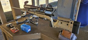

Mounted and shot it today. It's nice to be able to see holes (223) in my target @ 200Y. Only gripes so far are..
Throw levers clock position is wrong. It's way too close to the bolt.
Parallax was obscured by the ring. I'm sure I'll get used to reaching around and feeling for it.
Glass is definitely better then my old Midas Tac.
