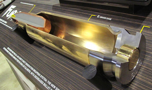

This effort (to develop polymer-cased ammo) has been underway for some time... but metal will not be abandoned completely it seems. The new SIG .277 fury round developed for the U.S. Military features a hybrid case, but not polymer with brass lower section. Instead it is mostly brass, but with a harder "alloy" from the head and rim. This allows the case to accept extremely high pressures -- way higher than typical SAAMI maxes for other cartridges.
This is worth reading. I think there may be applications for hunters. Get large magnum velocities with a standard short action receiver shooting a medium-sized cartridge.
Story link (click and then scroll down): https://bulletin.accurateshooter.com/2020/01/shot-show-2020-day-one-opener/

SIG patent application entitled MULTI-PIECE CARTRIDGE CASING AND METHOD OF MAKING, notethat the patent application also describes a multi-piece pistol cartridge case. SIG Cartridge Case Patent Application 2019, US20190226817A1.pdf
The alloys used in the case head and body can be very different then brass that we are used too. The patent is saying pressures as high as 120,000 PSI for rifles.
The hybrid case gets rid of most of the extraction issues of the higher pressure.
