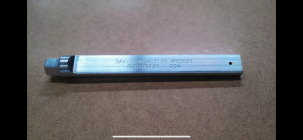

I like and use this style because its 7075 Alum
So is strong but doesnt hurt the finish
It slips in through the side port and engages the lug area
Doesn't need any extra sockets or Wrenches etc

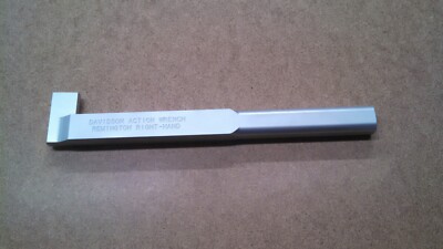

The Davidson wrench is my choice.
The steel through-wrench (upturned at the back) is all I'll use. I have a Kelbly's and the PMA is a clone of it. I can't imagine how many barrels I've removed with it over the years. Works on anything with a 700-style raceway (Remingtons, Kelbly, Borden, the 700 clones, etc.).

Davidson rear entry is what I have. Would take me more $ in time and material than what I can buy it for so that is what I did. Not disappointed. It’s a bit more expensive now than when I bought mine but still top notch. Won’t fit a Pierce though… found that out.
