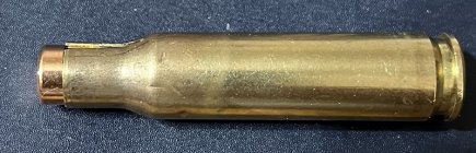

You mentioned my .308 freebore. It measures .120 for a case length of 2.010. Allowing for the radius of the flatbase bullet that I used, figure on more like .130.
