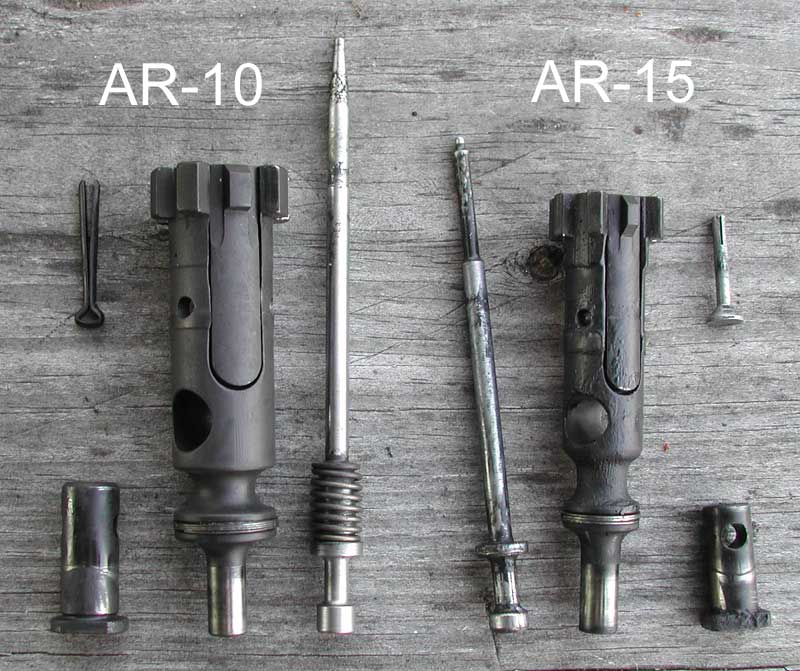

Always release the bolt on an AR, or any semi auto, but make sure there’s a mag in it. I know a few people who didn’t and had slam fires with AR 15 and 10’s floating firing pin
The follower slows it down enough
Unlike the AR-15, the AR-10's firing pin is not floating, there is a spring with the firing pin.
Ok Mr technically right
However after you gave us all a lesson in minutia and terminology, explain to us how that has any affect on the need to put a nag in when closing the bolt on a round in slow fire and out of battery detonation

The AR-10 was designed with a spring for the firing pin and there was a good reason for that. I don't know what a DPMS is but I'm guessing it's a cheap knock off of an Armalite AR-10 and they cut too many corners.

I wonder if something besides the firing pin struck the primer.
An AR-15 firing pin cannot reach the primer until the bolt fully cams into the locked position, and I am pretty sure it is the same on an AR-10.
