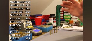

I don't know about that.... I have some IMI 5.56 that has considerably less internal volume than the same period (late 90s) Winchester brass.
IMI is not Lake City (or Winchester) which is what the military uses. It is well documented that Lake City is on the higher end of capacity, Winchester too. Lapua has less. Here's one example from a video Johnny's Reloading Bench did years ago.
IMI is the only military brass I have to go by. I don't have any LC brass.
