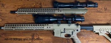

This is my AR-10 Armalite build with a McGowan 18" SS 1-10 twist 5R rifling mid length gas, adjustable block, muzzle is threaded 5/8x24. You just need to specify DPMs style or Armalite style. This was the break-in period group, with 150 production Rem bullets, a wet bore Sweet Shooter break-in. The 308s are heavy, compared to the AR-15s, this one AR-10 is a 308/260 deal. The 260 is a shooter in the .13 catagory. I have about a half dozen McGowan SS barreled guns they do shoot. Does not mean evervone shoots always, but mine do shoot. I just bought the barrels, have nothing to do with the company, but they are good to do business with, know what you need and what you want, right up front, you get what you order. According to the guys they mostly make DPMs style barrels.

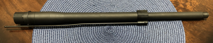

If your interested I have a brand new Rock Creek 308 barrel with gas block and tube. I bought a Seekins SP10 that came as a 308 and before a single round was ever shot through it I swapped it over to a 6.5 Creedmoor so I have this new unfired barrel complete with gas block and tube. Seekins used Rock Creek for their barrels on these.AR308barrel.PNG
how long and is this armalite config or ??
If I recall it's 18in but I can confirm that later when I get home. You'll have to excuse my ignorance on AR10's but I don't know what "armalite config" means. Not sure if this helps but this barrel came off what was a Seekins SP10 308 that I bought brand new and as soon as I got it home I pulled the barrel off and put a new Proof 6.5 Creedmoor barrel, gas block, and new gas tube on it. Proof barrel was their +2 so I had to use their longer tube and the journal size was different for the Proof barrel so I had to install a different gas block as well that's why that 308 barrel includes gas block and tube.
