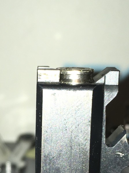

Here's a passing pistol plunk , The fact pistol headspacing is quite generous you can actually tell if you're gtg at a glance . We can't see that when plunking a bottle neck rifle round . Maybe a rimmed cartridge you could and I'm not sure about belted .

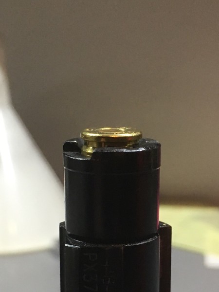

Here's that same round being plunked in a PX4 Storm barrel which would likely be similar to a rifle barrel . What does this photo say ? Does it pass ?
