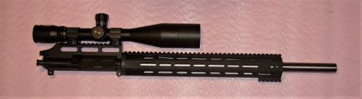

Here is a picture of the rifle that I use in AR benchrest at MCSA. The lower is all custom with a Giesslle trigger. The upper is an off the shelf WOA 223, 1-8 twist Wilson bbl. I shoot 73 gr. Bergers with 8208 set at mag. length. I have always shot it as a repeater if I want to shoot a single shot I have plenty of bolt guns for that.

What grip is that? And, is there something going on with the charging handle? It looks orange colored.
