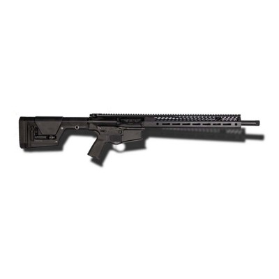

I'm not sure if Seekins shows their SP10 on the website anymore but there are a few of them around. My gunsmith has a Seekins SP10 6.5CM that right out of the box was so impressive I went out and bought one myself. Mine came as a 308 because I couldn't find one in 6.5CM so I put CF wrapped Proof 6.5CM barrel on it. Seekins makes some fine shooting AR's.
Not cheap, nothing good ever is, but it appears Scheels has one if you're interested.
