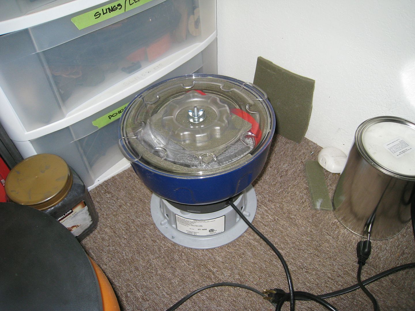

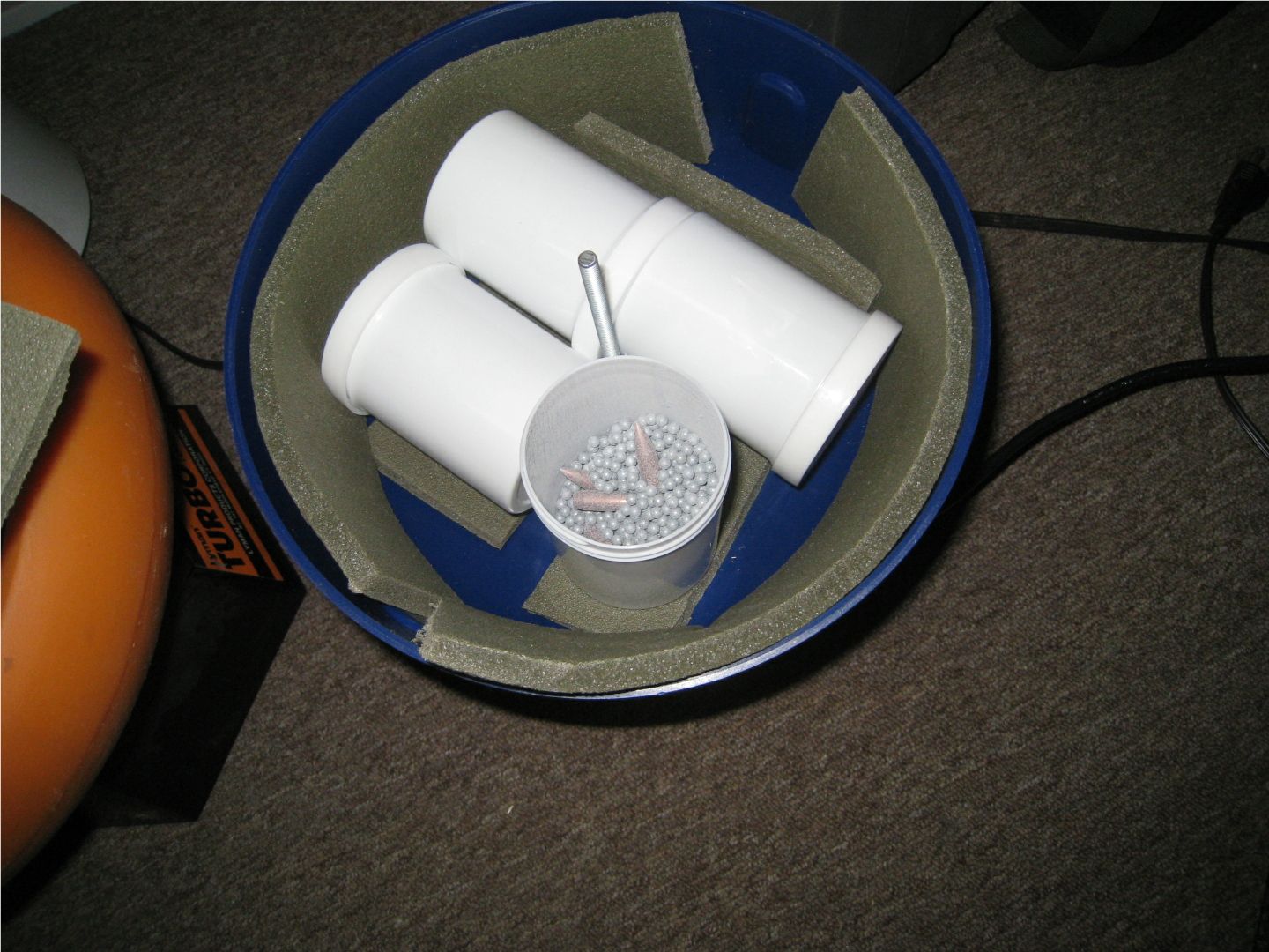

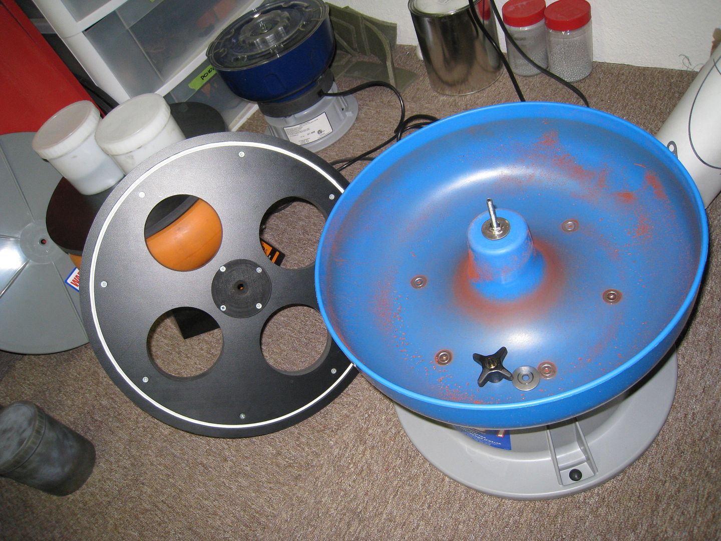

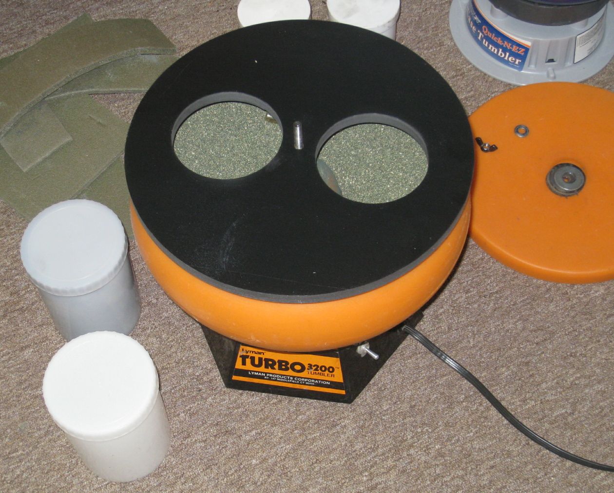

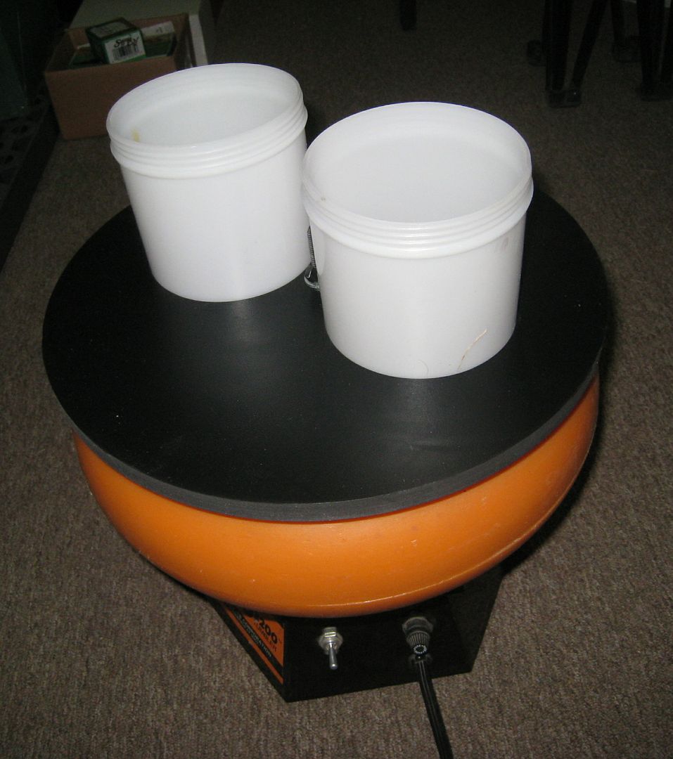

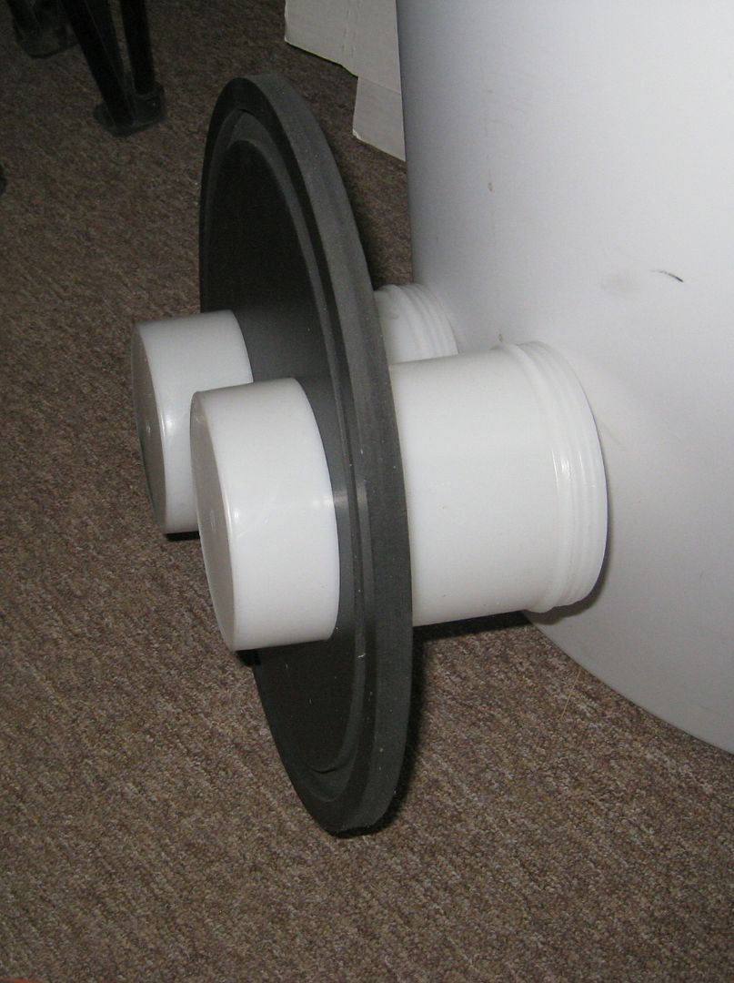

I took a piece of 1/2" thick Sintra (expanded PVC), routed a channel on the back to fit exactly over the rim of a tumbler, cut two holes the exact size of the lower 1/3rd of two plastic jars and cut a center hole for the shaft and wing-nut. (no comments, Will)
Slide the jars in till they're tight, add the .177 steel balls and impact coat. You can even leave the media in the bowl if you want to clean brass at the same time.
This setup keeps the center of gravity low and the shaking is much harder and sharper without the cushion of small jars floating in the media.

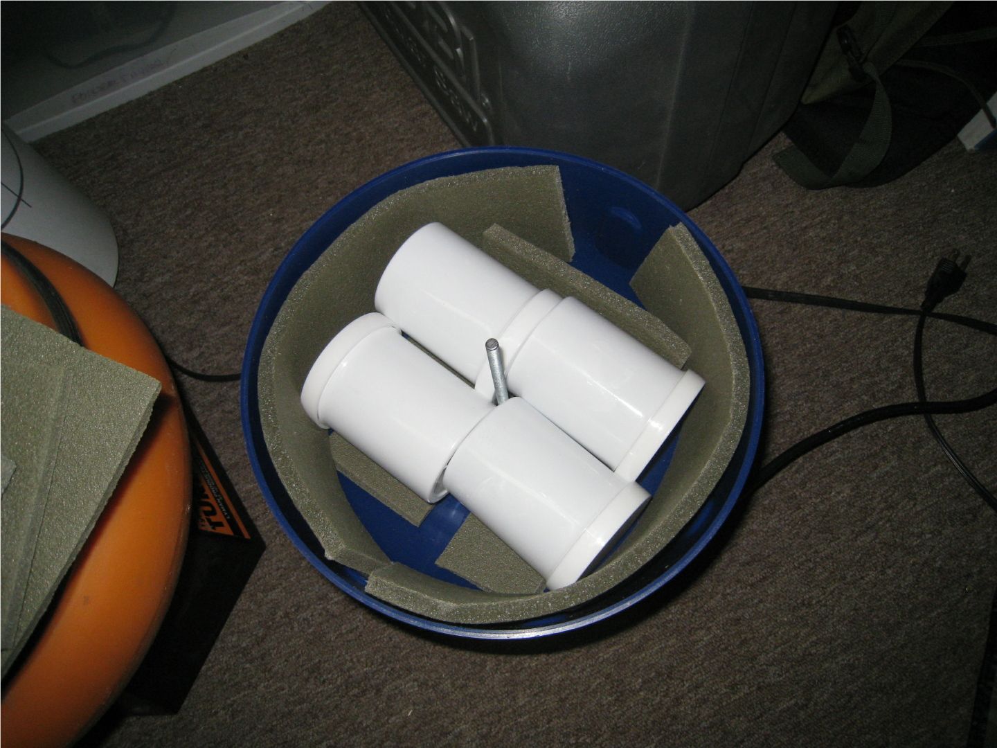

Tumbler with jars removed. The media is inside so we can do brass at the same time as impact coating.

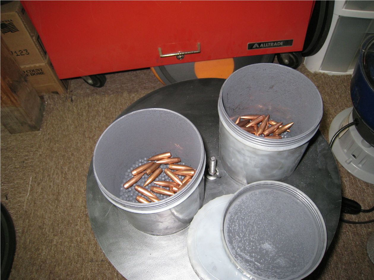

Dedicated vibrator tumbler, 4 plastic jars, 4"x2.5", 1/3rd fiilled with previously impact coated .177 steel BBs, 10 to 25 175SMKs, .6gr of negative 5 micron hBN or (if you're doing Moly) 1 heaping teaspoon of Lab Grade Moly, 99.9% 1 to 3 micron size.
1/2" thick dense foam padding below, sides and on top compression trapping all four jars. NO media.
Tighten top and vibrate for 3 hours.

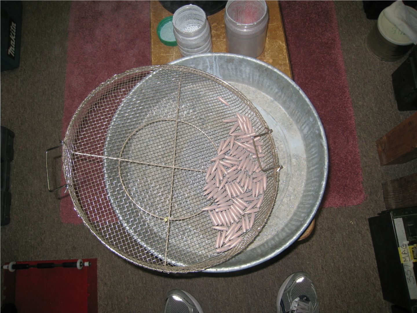

Ball and Bullet washing.
Hot, soapy water.
Now they dry overnight on a Terry Towel.
The steel balls and bullets were brand new right out of the box, but after washing, the water was grey and dirty.

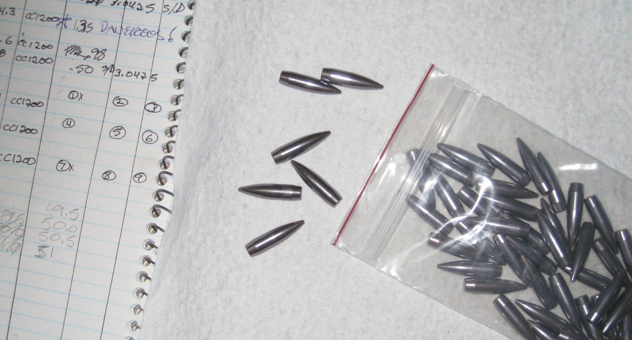

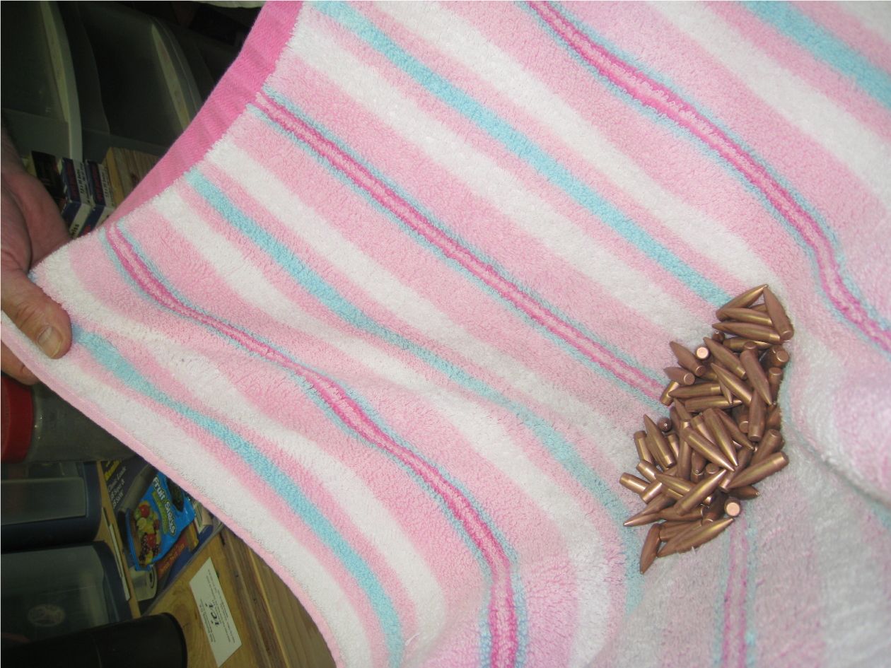

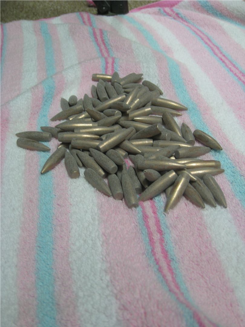

The bHN impact coated 175s , frosted looking right out of the jar.
After rolling in a terry towel, you can see the satin finish.

We use large pharmace pill bottles for these. They're large and hold a greater number of BBs and bullets.
He took a piece of 1/2" thick Sintra (expanded PVC), routed a channel on the back to fit exactly over the rim of a tumbler, cut two holes the exact size of the lower 1/3rd of two plastic jars and cut a center hole for the shaft and wing-nut. Slide the jars in till they're tight, add the .177 steel balls and impact coat. You can even leave the media in the bowl if you want to clean brass at the same time.
This setup keeps the center of gravity low and the shaking is much harder and sharper without the cushion of small jars floating in the media. This is the way to truly impact coat.
.177 steel balls into the bottom 1/3rd of the 4.5"x7" plastic container with two full teaspoons of 99.8% 1-3 Micron Lab Grade Moly and vibrated for 3 full hours.

Polish them lightly with a rag and they should look like this,... very smooth, solid deep pewter blue color and you should not be able to
scratch the Moly from the surface with your fingernail.

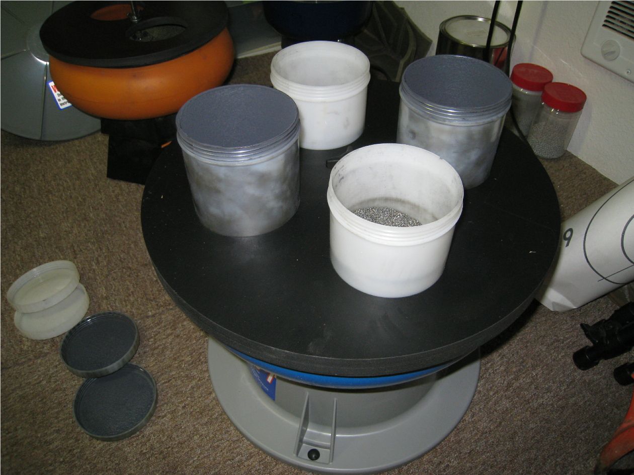

The Dillon Commercial with the custom top made in the shop with our CNC. Accepts 4 ea 4.5" x 5.5" sealable jars. Two are for Moly and two are for corncob. The center of gravity is kept low and the heavy duty motor provides maximum impact.
The Frankfort vibrator, padded with dense foam accepts two medium sized P-nut butter jars. They're both trapped between dense foam top and bottom. Without medium in the vibrator the maximum impact is achieved.
