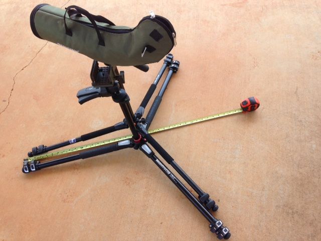

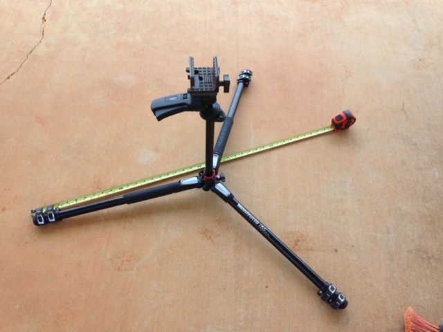

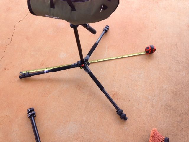

My buddy happened to bring his Manfrotto 055 to the range yesterday. So I took out the tape measure and snapped some pictures. Both are 3 section tripods. Both were aluminum. Here are my observations.
Manfrotto 055 profile measured at 3ft 2inches.
Alta Pro 263AT profile was 3ft on the nose. Negligible
I believe both could have gone one click lower and been maxed out, but they were low enough for how I would set up on the range.
Manfrotto build quality a little better. The legs were thicker. Removing the head to it's 90 degree position was tricky for me, but my buddy did it quickly. I later watched him struggle to put the main shaft back in there's a ball swivel. The Manfrotto was noticeably heavier. I didn't bring a scale out. The leg locks were metal and heavy duty, but a little hard to depress to me.
They have basically the same profile in terms of lowness.
The Alta Pro had more much more adjustment when you cam the main shaft over. They market from 0-180 degrees vs Manfrottos 90 degree. As far as camming, you have to release a QD style lever, and then depress a small brass button then run the shaft up to a marked point before locking the QD lever. It's a two hand process. It's akin to locking an umbrella, it's not rocket science. The leg locks were plastic but more intuitive and easier to use for me.
I can't speak to which goes lower. I'll defer to the above posters and say the Mafrotto does, but really from a practical standpoint it doesn't matter. You wont need the spotting scope that low, your firing position will be above it.
I'll argue the Manfrotto did seem more heavy duty. If you plan on field use (hunting or tactical shooting) I'd get the Manfrotto despite the extra weight. For the precision sports where you're not planning on shooting off the tripod or slamming it around I'd get the Alta Pro. I fully expect for how I use it the Alta Pro will last me 20+ years.
They have basically the same profile in terms of lowness. They do basically the same thing. One has a much lower price tag. But No they aren't Identical. YMMV.

(Note that this is not the lowest setting on the legs. Going lower would slightly increase the profile overall length.)
Alta on top Manfrotto on bottom
Sorry I meant to post these for you yesterday, but I was extremely busy.
3ft is basically what you're looking at either way you go. The Manfrotto is infinitely more popular but they both accomplish the same objective so pick what you feel you can budget for.
