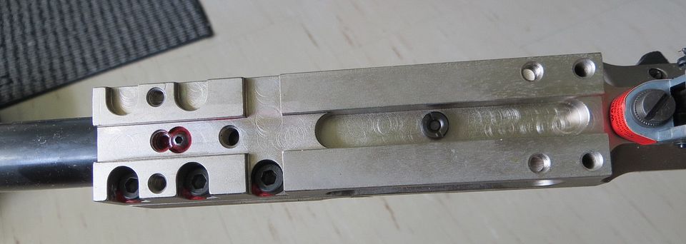

Yes, there does appear to be an extra hole. I'd say it's roughly where the front bedding screw would be on a Match 54.
The block at the rear only has one hole though. If it's for a bedding screw, that has to do double duty holding on the trigger too.

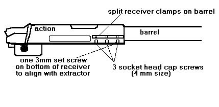

It's not clear that there's an extra hole that's non-factory. Below is the bottom view of a 20xx receiver from 1996 that hasn't been modified.
The screw with red epoxy is the set screw for aligning the extractors.
Almost correct. No big deal but that screw is to lock down the cup head to the left, down into action, which indexes on a flat on the tenon. Once bbl was installed you wanted to back that off a bit.
