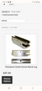

I got an itch to make my own contender barrel. Has anyone done this? Have any advice you'd like to share?
Also, does anyone know where you can get lugs? I can find Encore lugs but not contender.

I saw the encore lug at PT&G, but I need a contender lug. They are not the same. The encore lug won't work with a contender frame. Been checking with some of the contender barrel makers to see if they will sell me just the lug.

The Encore lugs as sold by PT&G don't have the pivot pin hole yet(for obvious reasons). So to do the job properly you will need a milling machine to locate and machine the hole.
If you have a mill, that lug would be a very simple project. Machine to dimensions, three holes, two slots. Nothing complicated at all. I don't own a Contender, but I can't see it being that much different.
