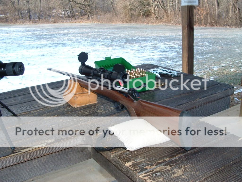

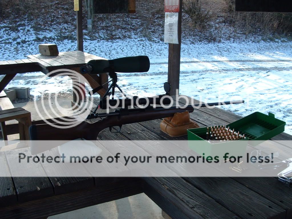

Pics of the raffle rifle (I am giving it to my Brother for Christmas, my nieces pitched in for a Leupold Euro 3x9.)
Deer Season cold...Range temperature on Sunday 15 F.

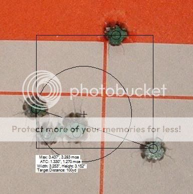

I tried H4831 with CCI 250 primer, 47.5 gr being best for group with weights to 49.5 in 0.5 increments, 110 Gr Nosler Accubond. I thought it odd that lowest charge performed best for the day.
Boy that range sure looks like one near Saltsburg, Pa. and Kenny Bee's Gun Shop. Used to live near there before retiring here in Florida.
Sub MOA with my "worked" Sendero and 55 gr. IMR 4350 and 115 gr. Nosler Ballistic Tips. Do moly those bullets myself so that may be a factor to note. Use mag primers also.
What's that white stuff on the ground? Saw some of that during the Steeler game yesterday. Cold heh?
I was in Gainesville, FL last week for work, and it was pretty damn cold down there too!
I was on the fence between IMR4350 and H4831, may try and work that into future loads.
PS: This is the Dormont-Mt Lebanon Sportsman's Club in South Strabane Township, near Washington, PA. Funny, most ranges up here all look the same...
Coached the Penn Hills High School rifle team for years. Think we went there one Summer to shoot against Mt. Lebanon and Trinity.
Memories. Thanks.
