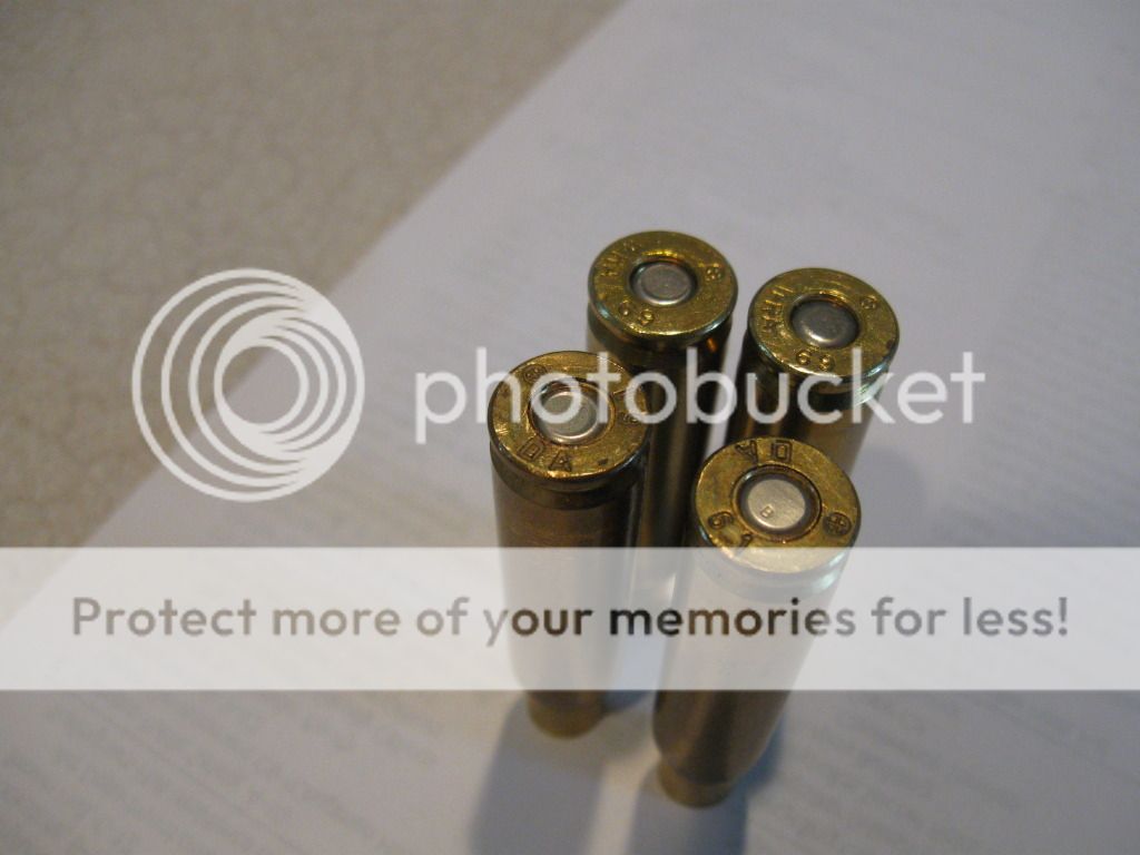

When I started using it, I started having more FTF's than I ever had in 40 years of loading, using some of the most questionable primers one could imagine.

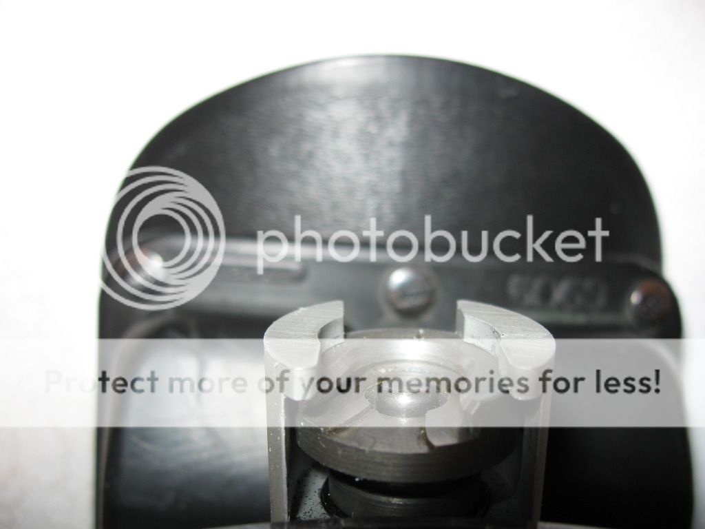

Hornady for some reason they won't reveal has put a rather large radius on the edge of the seating face of the punch. This focuses all the seating force to the center of the primer face and if a primer is a little "stiff" going into the primer pocket it "dishes" the primer face. EVERY SINGLE MISFIRE that I've experienced whille using this tool has the distinctive edge marking of the dished primer face.
Can anyone explain to me the value of the radius they insist on applying?

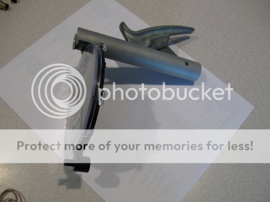

Here's a couple pictures of both the "punch" and a couple of cases I primed using both a BR-2 primer and a Wolf Primer.
Just wondering if anyone could clue me in because Hornady has been no help.

That's the problem, the tool is pretty much pre-set for depth. It bottoms out at the top of the stroke. If you shortened it, you wouldn't be able to fully seat. On my older tool there's a little washer/bushing pressed on to the stem, and in theory if you had to, you could move it. Looks like on the new ones it's actually machined into the stem?

Yes, the brass in the pictures was military. I used them to illustrate the problem when I sent the pic's to Hornady. The primer pockets were swaged with a Dillon Super Swage and actually went into the pockets pretty easy. I purposly squashed one of each to illustrate how the punch damages the primer when running into a tight pocket as I experienced with a bunch of Lapua as well as Winchester .308 brass.

The ram is adjustable. Hornady just tells everyone it isn't. Inside the piece the ram sits in there is a set screw. Hornady sets this screw at the factory and then puts a drop or three of blue loctite in the socket. When you look in the hole all one sees is the cured loctite so it doesn't look adjustable.
A couple of drops of acetone or laquer thinner (I used the latter) and the loctite can be picked out of the socket of the set screw and adjusted as needed.
Since I posted, I just chucked the punch in a cordless drill, went to the grinder and removed the domed top of the punch. I then just broke the sharp edge, polished off the face with a diamond lap I have on the bench. Took a couple of trial and error adjustments but I now have a tool that even with Wolf Primers that tend to be a little tight when seating, I have absolutely no "dishing" of the primer as I had before.
