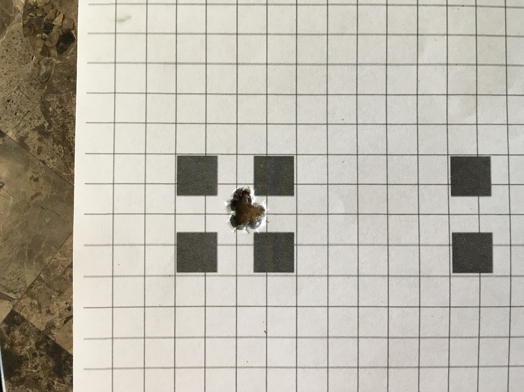

Im 0.010" off the lands with 41.4 - 5 gr H 4350 pushing 140 gr Berger Hybrid Target at 2750 fps (fast enuf for me) with SD of 6 and under half MoA.

Neither of my Creedmoor hates H4350, but my match gun seems to have a slight preference for Varget behind 130gr AR Hybrids. Pushes them to 2900ish from 24” Bartlein and shoots well, group shown below.
Since your shooting 130s, give Varget a try.
