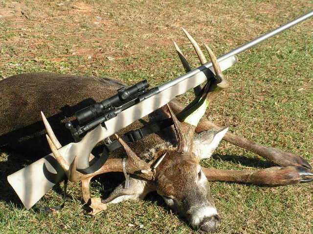

2005 WI Public lands whitetail
In 2004 204 brass became available and was about as much as you could get out of a .378 bolt face without resorting to rare Euro brass 5.6x50 Mag. Today the 6.5 Grendle is quite common and is only .007" larger with nearly the same capacity with 100gr NBT's and Partitions available I would have a hard time justifying building a wildcat. I have a 6.5 Grendel Mini Howa. I also shoot rifles in 22-204 and 6mm-204 all fine cartridges for a .378 bolt-face
6.5G Mini Howa 90gr TNT
