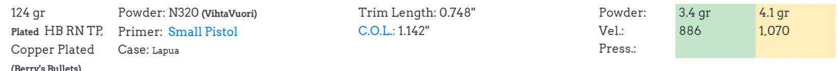

I finally bought an InterArms Swedish Luger. It’s been on my bucket list for a long time. I’ve searched for info from people who own them and have read everything I could find. Information is mixed on what loading works best in them. Does any member here reload for one or know someone who does? I’d rather not damage the gun with loads that are too hot.

I’d look up the military load bullet weight for the pistol. Then look in my loading books for starting loads with that bullet weight. Load a few and see if they cycled the action, then up the load till they do. That should put you on the low end of the workable loads. I’d use W231, but that’s mostly because it’s on hand.
I use American select 3.8g with a 122g hard cast plated with Servicios Aventuras small pistol primers at 1123fps it is very clean burning .
Thank you all for the load info but I’m looking for loads specific to the Luger. I recently finished loading 2000+ rounds for my various 9mm handguns.

As mentioned earlier in this thread....start low with 231 until you get 100% cycle rate and call it good . The P08 isn't that beefy when it comes to loads.
If you want original loading for that gun then you need a 124gr truncated cone bullet. You will find that this profile is the most accurate and best feeding bullet there is in the 9mm. Load to right at 1000fps

I've done as much reading about Lugers in general as I can find and from what seems to be a common thought is they were originally designed around the 124 grain bullet.
MY UNDERSTANDING IS THAT ( +Plus ) SHOULD NOT BE USED, in these guns.

I asked a friend that is an avid pistol shooter and a military weapon collector. I think almost all his are shooters. He told me he has a 1936 Mauser Luger and he uses 4.3 gr Bullseye with a 115 gr bullet, and a CCI500 primer.
