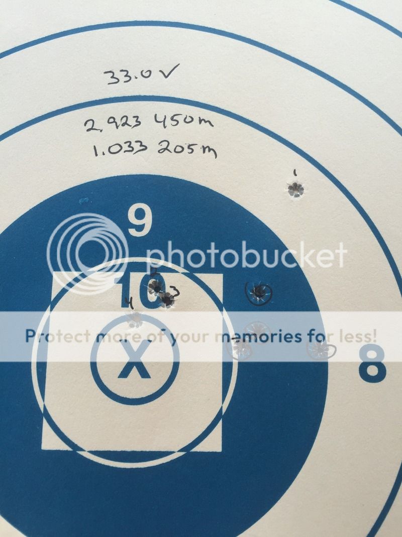

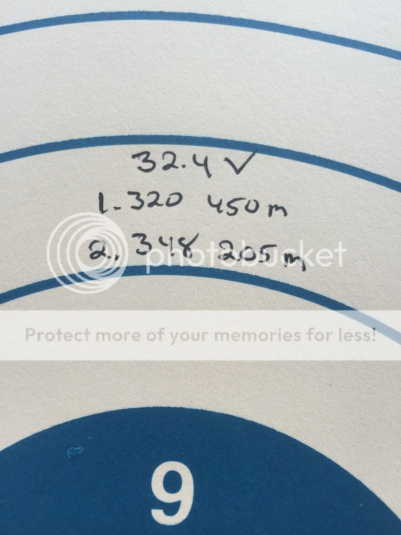

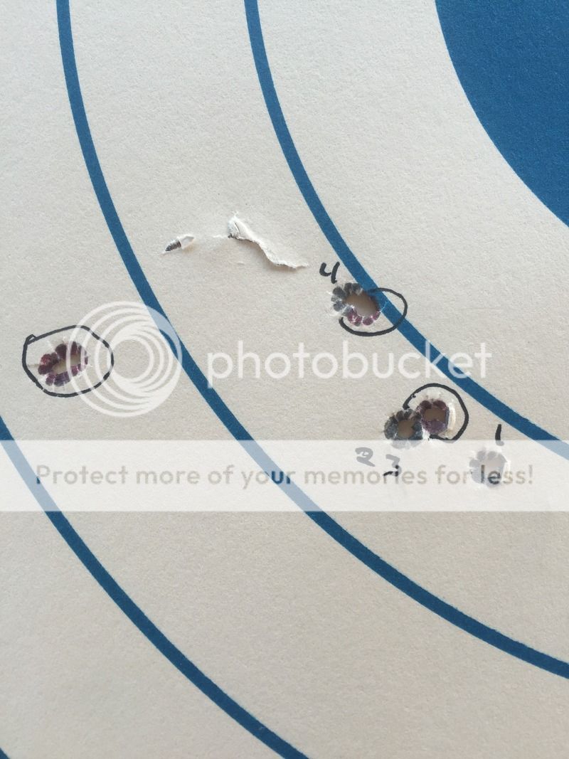

This am at 6:00 sharp I'm up and out the door. I packed the HG with the Brux 1-8 twist barrel at 30" with my new chambering. Today's testing was done at 600 yards using a Sierra 107 (old style) bullets seated -.015 and Varget powder. I tested 2 primers the CCI 450 and the F205m. The groups are four shot as I didn't have enough fire formed cases to do 5 shots for 4 different powder charges and two different primers.
Also note I circled the shots that are the 205m and numbered the CCI 450 primers.
Group sizes and charge weight are written on each Target.
Target 1
Target 1 stats
Target #2
Somehow I didn't get one of the shots in the photo sorry for that.
Target #3
Target #4
I decided to push it and upped my charge another .2 from yesterday so this one is at 33.0 and it showed a slight cratering on the primer.

on that 33.o target is where I am not good enough to tell if that one shot is the load the conditions or me,,

Hi James. that last load (30.3gr V) looks awesome on the vertical, you might want to try that load some more playing with the seating. If it (seating) brings the shots back together in horizontal, maybe then some - and + 0.1gr load changes from the 30.3 charge to see if you can pin point what that barrel likes. Right now the barrel looks great and your shooting awesome. I really believe you are into a GOOD thing at this point.
