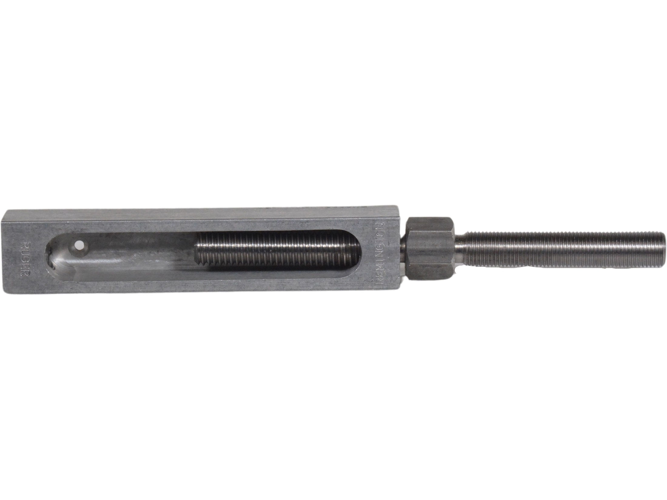

All you need is that tool to get the pin assm out (Look around for cheaper ones, I feel like I paid 12 bucks for mine)
One of these if you ever want to replace the spring:
And a punch set to get your ejector out, extractor can stay.
