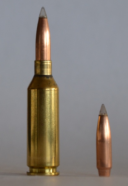

We should encourage Blaine Leisy to make more of his 55 grain Poly-Tip Rebated Boat Tail bullets:
He can be reached at blackholebullets@gmail.com but remember your rifle should be an 8-Twist or better...

Got some of the Black Hole bullets in both 55gr rebated and 45gr cup base can't wait to try them out also got some 62gr Unmissigs to try but I don't think a 9 twist will stabilize them
20-250 with 62gr on left, 20-250 with 55gr middle and 20br with 45gr right
