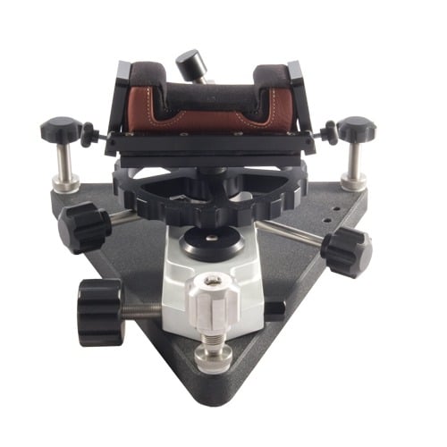

Any input on this front rest?
6BRA
Has anyone ever had 1st hand experience with this rest? Length of time it has been on market? Anyone using in benchrest? This is alot like a JJ LOH.
Waiting on reply from manufacturer.
The quality of the rest appears to be there in the pictures. It is pretty refined in finish.
All I need to see... I already have a Neo X and my asking questions may be indicative of something.
I've never seen anyone run the screw that high, it's asking for trouble in my opinion.
There is a reason there are leveling screws and I believe it's called gross or coarse elevation on a Sinclair.
That collar that sits in the base then the screw screws into it so between the two of them you can keep the screw low/deep in the collar and the collar clamped down.
I haven't owned a Sinclair for a year now and haven't shot off one for 2-3 years but isn't there also a screw to lock the elevation screw down???
I want to say there is but can't recall. I'll find one tomorrow and look.

IMO, at least for short range, you need a rest that allows the plate that the bag sits on to get down to around 5" above the bench top with the points deployed. That rest seems to be too tall. The one that it is a knock off of would go a lot lower.
Boyd,
Please explain more. I am not arguing, wanting to understand. Why does rest height matter? Isn't barrel torque associated with weight/mass all above the bags? Trying to keep weight as low in bags as possible?
Other than I can see a higher rest having more flex as demonstrated in Stukey's video. Why does height matter?
Mike
It appears all the pictures shown on the Revolution site are with the optional 1” riser installed. I sent an email asking what the minimum height of the bag plate is. I will report back if I get an answer.
I received a reply from Dennis at Revolution machine and he states that without the 1” riser installed the minimum height of the bag plate with feet deployed is 5”.
What is your opinion on why you want the rest so low to the bench top? Would it make more sense to shoot prone and get the rest lower? Or move to an area of the country 100 feet above sea level? Instead of 760 feet above? In all seriousness, what is the purpose of keeping a gun low to the bench? Why the need for 5 inch?
If you run a tall front rest you may need to use spacers under the rear bags.
the rest pictured in the adverstment looks like it has the 1” spacer under the windage adjustment block, I would order it without to start with and see how it goes.
Which has been my point all along, keeping center of gravity low to the bag surface, understand. There have been several mentions of 5 inch rest height and I just don't get it. Shooter must be comfortable.
I’m not saying 5” is or is not what you need. Was simply relaying the info from the manufacturer on what his rest is for anyone that’s interested.
