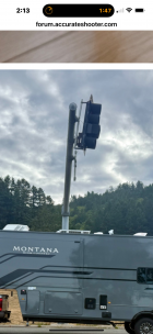

I will take some hardships over freedom, changes of scenery and ability to follow our preferred temperature gradient! I plan on holding the record for having the most amount of country shooting range memberships because most have rv parking!! Now I can even roll up some 357's on my dining room table with morning coffee and a view of a mountain lake! I am able to fit my 75lb shooting bench in the front pass thru and my Co-Ax bolts to it for rifle loading. Got it all figured out lol. 70 psi in the airbags compensates for the additional 900 lbs of guns, ammo, tools and paraphernalia ! I don't want to 'live' anywhere permanent anymore. I am 65 and seeing the proverbial light at the end of the tunnel. Not wasting anymore time waiting out cold and wet winters or hot summers to be outside. Maybe we will eventually find a cabin in a remote mountain area to base out of and then drag the rv to nicer climes in the winter. But the fun will be in the hunt and that will take time! And a big thanks to Elon and his Starlink for making this all possible!IMG_8127.jpeg

Your Starlink looks muchly different from mine. That must get a helluva strong signal! :)
