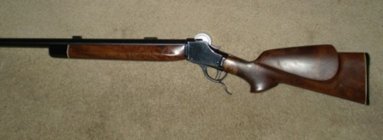

I have a Hi Wall in 225 Win, also. It has a heavy 28" 16 twist barrel (unknown maker). My best load to date is 33.0 Varget ( 1/2" groups) with FB 55 gr Sierra's. I've tried 4895 and 4064 (not as good as 4895). I have but, haven't tried FB 50 gr Sierra & Hornaday and FB 55 gr Hornaday plus Win fmjbt. I'll post on the other bullets by spring :) I'll try to get a pic, too.

Bob,
I'm in Oregon and bought it here but, it could have come from out of the area. Mine has the close couple DST triggers and a varmit type stock. I'll post a pic in a day or two.
Frank
Bob,
Here is my 225 Win. Hi Wall. Does it still look like the one you had?
Frank
Frenkeore
All looks close however the foreend and pistol grip area of mine were checkered, also i had no cap on the front of the forend. nice piece though, wood is great.
trigger, guard, cocking lever etc all look right.
you have a nice one but i do not think it is the one i had.
thanks for the pic.
bob
