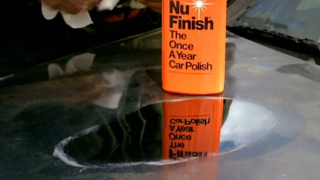

Nu-Finish is a paint protectant. It is neither polish, or wax.

I'm not a chemist and have read the articles about Nu-Finish, "BUT" a lot of people use it when case tumbling.
When I put Nu-Finish on my car it cleans the surface of the paint and removes paint oxidation and makes the paint shine.
And when I put it on my untreated walnut media the Nu-Finish helps clean the brass, makes it shine and keeps it from tarnishing.
The Nu-Finish also helps keep the dust down when its added at each tumbling.
Nu-Finish may be neither fish nor fowl but it does help when tumbling brass no matter the negative comments.
Below, for not being a polish or a wax it does something, and a lot of people use it.

It does in fact do something. It protects the paint. You can wipe on diesel fuel onto oxidized paint and get the same type of shine. Like Nu-Finish, diesel fuel will protect the paint.
The 5 steps to a shine:
1 - Wash
2 - Surface prep (removes contaminates)
3 - Polish (produces the shine)
4 - Protect (this is what Nu-Finish provides)
5 - Maintain
Nu-Finish doesn't remove the oxidation, it covers it.

Our mind is a powerful tool, as is good advertising. Krazy Kloth will provide the same shiny finish.

Yes, I have. The lizard litter is too fine to work in a reasonable length of time. The only thing I noticed when using Nu-Finish is that it causes the media to clump and reduces the little bit of dust created in the bowl. A couple of the custom bowyers I have build bows for me wipe on Nu-Finish over the clear coat they spray on the finished bow. It protects the finish, not shine it. They use it because it is the least expensive of the protectants/sealants. I owned a mobile detailing business for a number of years and know which products work and what they provide.
