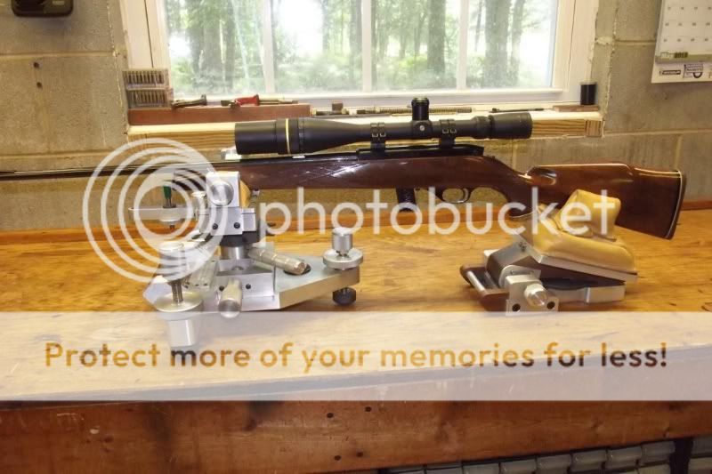

Another Home Shop Front Rest
The only real dollars I have invested is the bag. I have been given alum, brass, steel, threaded rod, nuts, bolts, etc by both friends and strangers. I always took the metals even if I didn't need them at that time, figured I might later. I came home one day and had a 12' piece of 4" round stock laying at the shop door. A friend found it in the middle of the road with cars driving around it. He got help, loaded it on his truck and brought it to me.
I probably spent more time designing the rest around what materials I had in stock than I did actually machining it.

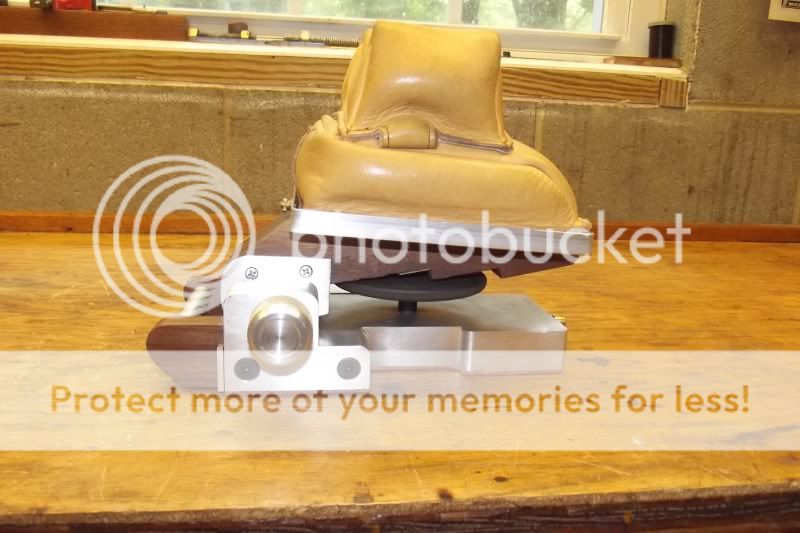

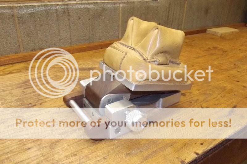

During one of our "senior citizens " outings one of our guys wanted an adjustable rear rest with the rear bag set at about 15 degree angle to match his rifle stock. He said he didn't like reaching forward to adjust the front rest. We are not only old but we are lazy too. So....went back to the shop and sketch pad this is what I came up with. It has about 1" of both vertical and horizontal movement.
Would you explain the mechanics of the rear rest please. I'm one of youse guys.

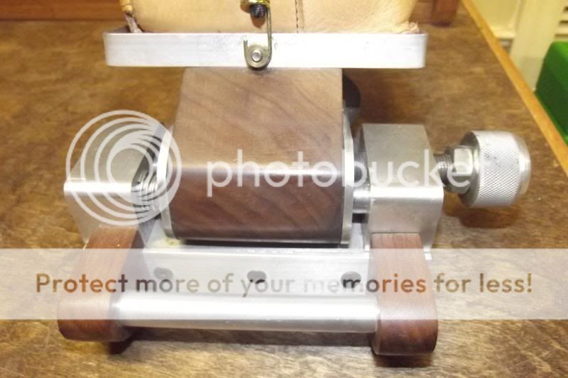

A picture of the vertical adj may be a little better. The black thumbwheel gives the vertical adjustment. The alum handwheel on the left side gives the horizontal adjustment. The center wood carrier has a hidden 1/2" steel rod thru it with a compression spring on the right side. The handwheel is threaded into the sideplate. The handwheel pushes the wood carrier against the spring to force it to the right, loosen the handwheel and the spring pushes the carrier back to the left.
I need a stronger spring but that one was all I had at the time. If I ever change it I would use a captive threaded rod in lieu of the spring system.
