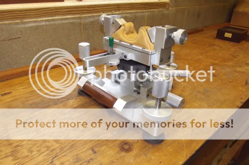

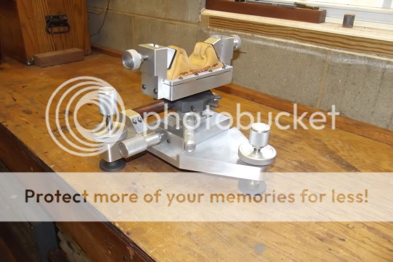

There have been a few posts of people either building or wanting to build a front rest, so here is my home shop rest.
First and foremost I am not a professional machinist, just an old retired guy with a home shop who enjoys shooting with friends, no formal competition. When I started looking for a front rest I was enlightened, what I liked I couldn't afford, what I could afford I didn't like. Printed a few pictures of what I liked and sketched what "I thought I would like" for our purposes. Looked around the shop, had Bridgeport, lathe, surface grinder, etc, had a stock of alum, steel, brass, and threaded rod that people had given me over the years. I now had everything to build my own rest, well....maybe short on ability. Went to work and this is what I came up with...not perfect by any means but it serves out purpose.
During one of our "senior citizens " outings one of our guys wanted an adjustable rear rest with the rear bag set at about 15 degree angle to match his rifle stock. He said he didn't like reaching forward to adjust the front rest. We are not only old but we are lazy too. So....went back to the shop and sketch pad this is what I came up with. It has about 1" of both vertical and horizontal movement.

Do the front bag side supports (at an angle) screw back to a flush position for a wider fore end?

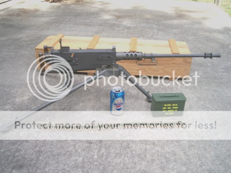

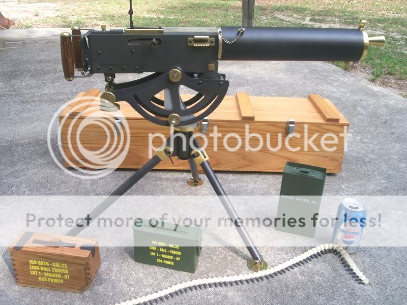

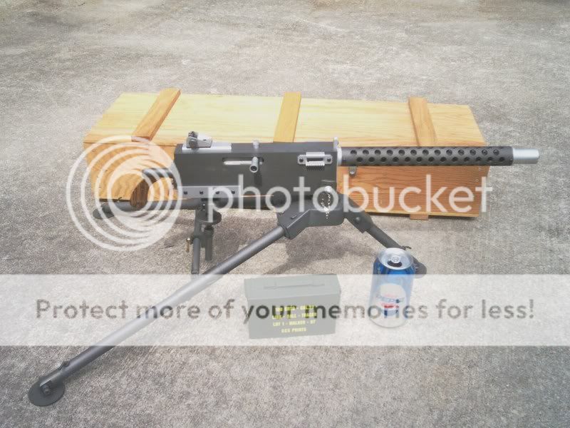

Jon: I have a Bridgeport mill w/ Accurite DRO, South Bend Heavy 10 Lathe (3 jaw, 4 jaw, Collet att, steady and follower rests, Harig surface grinder, Ammco 7" shaper, and a Jet (Roll-In copy) bandsaw. Nothing to bragg about..... but they do what i'm capable of. I also build semi-auto fully functioning 1/2 scale BMG's (1917,1919, and M2) in .22 cal.

M-61, yes the front bag supports retract to 90 degrees and the screws have replaceable bronze pressure pads as does the windage adj screw The legs also have threaded bronze inserts to eliminate wear in the alum. Don't know if they were really needed or not, but I put them in anyway. I had the bronze and the time, so I figured it wouldn't hurt.

OK phil. They are 1/2 scale fully functioning .22 cal scale models of the M2, 1917 water cooled, and 1919 air cooled BMG's. I use a Ruger 10/22 as a donor gun for the upper, lower, and barrel. This gives a transferrable ser # if needed. The receiver and barrel are modified to fit the housing but everything else is scratch built including the 1/2 scale ammo cans, tripods, transit cases, etc. The sights are cut down 03 Springfields. The belted ammo is for asthetic purposes only as the guns maintain the Ruger rotary mag feeds. The M2 is shown with .17 HMR ammo since it is a bottle neck cartridge but actually is a .22 LR. The Pepsi can is for scale.
