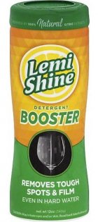

Lemi Shine !!
I've mentioned this before, but it seems no one else is using it except with their brass cleaning.
One day I had this bright idea to see if Lemi Shine would clean up my crown of my Krieger SS barrel or the break I had mounted on it. So I put a concentration of Lemi Shine in a small jar using very hot water and put my break in. Immediately it fizzed an the carbon and burt powder coating started coming off. After a minute I removed the break and rinsed it with some clean hot water. Most of the black was gone and then with some q-tips, I wiped away the little that remained. Then I took a patch and soaked it with some of that solution and wiped down crown and the black came off really fast, faster than anything else I tried.
Now, since that worked so well on those parts, I wondered how well it'd do on the carbon ring in the chamber. So, I soaked a mop and let it sit in the throat a few minutes, then brushed it with a bronze brush with some of the solution on it and the carbon ring was gone (verified with bore scope).
I only started doing this a few months ago and each time it's worked great. Has anyone else tried using Semi Shine like this?

That's "hard carbon" I went after is that carbon ring in the throat area of the chamber that I described. It's usually pretty tough to remove and the Lemi Shine + bronze brush took care of it.
Note that I emphasized "a concentration" of the Lemi Shine as it's much more than what one would use when cleaning one's brass. I wish I had made measurements to convey just what the concentration was that I used. But I'd guess that it was about a tablespoon of Semi Shine to ~4 oz of hot water.
So, what does my cleaning results with Lemi Shine look like? Here are some pics of my break from the inside looking out with a Teslong bore scope and one of the area where the carbon ring was:
Are Lemi Shine and Semi Shine different products or is that just a typo? Not being a smart ass. Really interested in this subject and want to know. Thanks!
