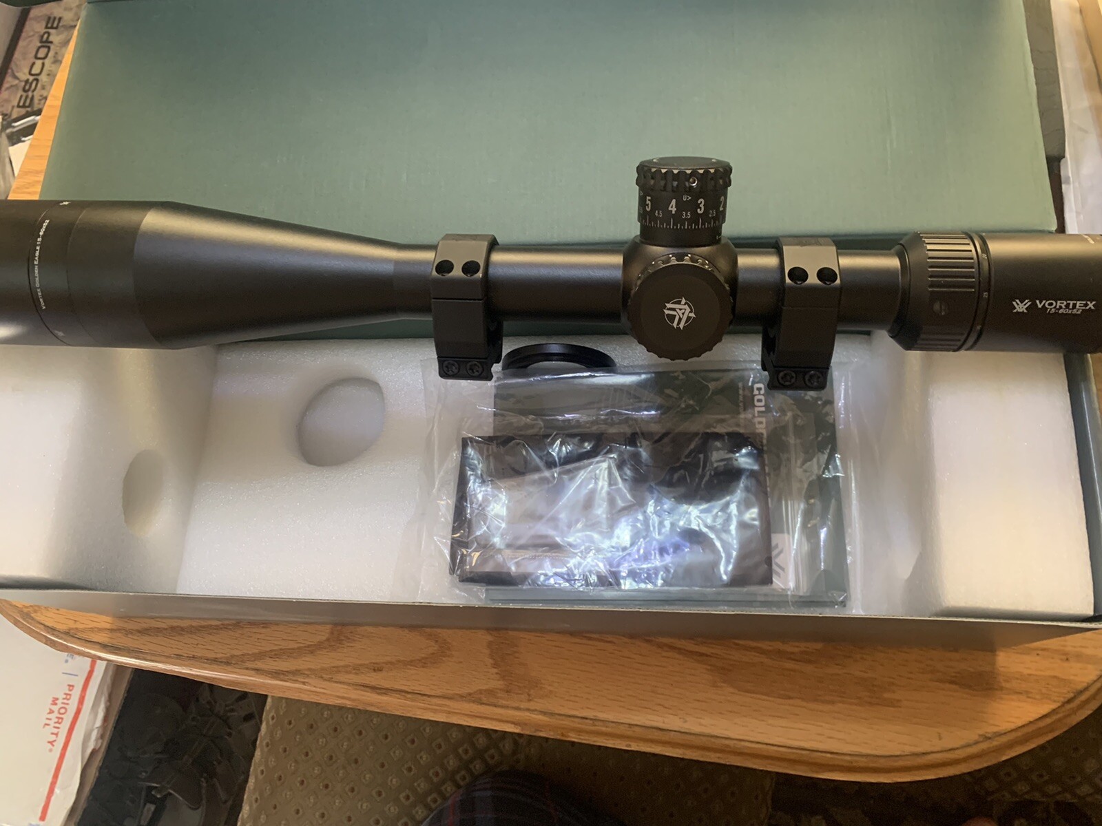

Well I finally made my decision on glass, it was tough knowing how proven the NF Benchrest 12-42X is, but I had to remember this rifles #1 use will be Varmints. So after much consideration, the Vortex Golden Eagle won me over on two counts.
1) the side parallax was a no brainer for much more practical adjustment when it will be constantly needed at various unknown ranges at the moment of truth.
2) I just can't think of a better reticle than this ECR-1, The floating .095 moa dot is just what I wanted, and the 1/2 moa reference's around it, coupled with 1 moa reference hashes, in their fine .016 moa thickness, will give great reference for target use when I install the 6x47L barrel and head to the range as well. But lots of useable field reference, with a pretty uncluttered reticle was big for me.
I also am assuming since its a 15-60X, 20 to 40X should be in its sweet spot for glass performance, where I plan to use it most often. I bagged it on cell tower 1076 yards away the other evening and was quite happy with the image, watching a couple sparrows or maybe starlings? as well as checking out the wiring job and all the wire ties at that range.
The only thing I still have not verified is, how far off on the range will I be able to make out the 6mm bullet holes? But for long range varmint, I am sure it has me covered! The rings on it will be replaced with Burris Signature Z rings. Just waiting on the call now!

Seeing hits at distance is going to greatly depend on weather. Once the mirage starts getting up, all bets are off.

A final word about Vortex Optics, I could not have asked for quicker, less hassle service expediting taking care of this issue! I was on the phone less than 5 minuets total, with no questions of where I bought it, or what I used it for, nothing, I simply replied why I was calling and the first this=ng the CS person said, was we need to get this here and taken care of as quickly as possible! within 10 minutes of making the call I was printing a return label, and return authorization. I shipped it Thursday morning, I will respond here with a follow-up as soon as it arrives back in my posession.
