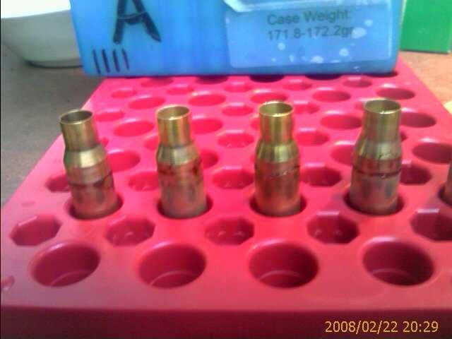

I did put the TempiLaq down just below the shoulder as it showed in the B&W picture in the destructions... Basically there's still a 'ring' that didn't quite burn/boil off. I'll try the paint thinner later.
As to the color... that was why I wasn't quite sure if I was doing enough... not quite the full color change spectrum that I see in new Lapua brass. I'm working on uploading a couple pics of what I'm seeing on this end, but I'll have to work out a few wrinkles w/ my image-hosting site later.

Okay... got the image problems sorted out,photobucket doesn't like jpgs fresh from my new smartphone... had to open them in IrfanView first and then 'save' them over the originals... dunno why, but it worked)
Anywho...
Here's a 'before & after'... 'before' on the right,'after' on the left:
And here's four of the cases shortly after being annealed. You can see the 'ring' of boilt TempiLaq below the shoulder:
