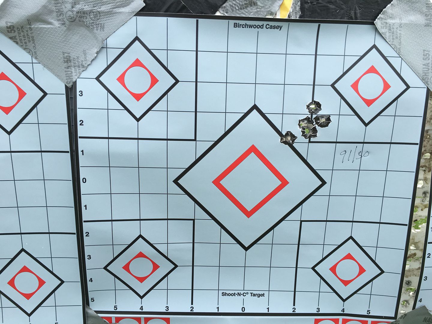

OK guys, I was able to get to the range today with some of the Hornady 303 and for a quick test to see what would be good I loaded up 5 of each with 42gr, 43gr, 44gr, and 45gr of Varget with a COAL of 2.855" at 100 yards using the stock iron sights that comes on the MN. The 42gr and 44gr look promising while the 45gr was just plain horrible. Here's a couple pics of the 42gr and 44gr groups. Of course each group had a flyer or maybe it was me so I didn't measure for those. The 43gr group I messed up and will have to redo them but they looked really good, maybe the best. I'm confessing now that I had a hard time trying to see the target using the iron sights and holding exactly the same each shot so I'm almost positive I could have done better with a scope or somebody elses younger eyes. I don't know, maybe these groups are good for these old rifles?
Hosted on Fotki
Hosted on Fotki
Groups look good. Seems like your OAL is short. I'll have to check but I believe mine are around 3.00.
