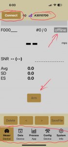

The start-up screen has you on Measr Device. That tab is where the app is essentially presenting a second display of the chronograph. And it’s where you’ll be when you’re actually shooting.
The first time you use the app you’ll need to enter the serial number of your chrono – A30107D0 in my case. Happily, that field is persistent so any time you open up the app after that it will be pre-populated.

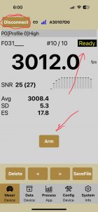

You tap “Connect” and, voila, a couple seconds later the app and the chronograph are talking to each other. The app’s screen will then display the main screen from the chrono, with the current shot series in progress. In my example here, I’m on file F031 – a series that has ten shots recorded. If I touch the “Arm” button on the app, the chrono will arm itself. And if I then send a round downrange, that eleventh shot would be displayed both on the chronograph and the app.
The whole process is clean and simple. It takes only a few seconds to set up. And there’s not a lot to go wrong.
When you’ve completed one series and are ready to start another, you simply touch the “SaveFile” button on the app. That’s it. And that’s one area in which the AndiScan app beats the Garmin – as changing series on the Xero takes a handful of button presses.

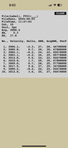

The second tab on the AndiScan app is Data Device. That gives you access to your series data actually on the chronograph. You can filter the display of that data in a few different ways, but it’s important to remember that you’re looking at remote data – that data is not held within the app itself.
To copy a file from the A3 to the app, you simply touch the desired filename. That downloads it from the device into the app.
And as the second picture below shows, you can quickly get a macro view of the series and how the shots compare to one another.

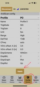

The Config Device tab is beautiful. First, it allows you to see at a glance all your chronograph settings. And, second, it allows you to change any of those settings with a few quick finger taps.
The difference between making configuration changes via this app screen compared to the slow, clumsy process of trying to work through the physical buttons on the A3 itself is like night and day.

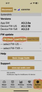

And, finally, there is the System Info tab. Its purpose is to display the current firmware versions; and then to update those firmware versions, if desired.
Updating firmware is very straightforward. Touch the “FW Check” button and the app will connect back to the AndiScan’s home servers. You then select the desired FW-US and/or FW-TXR file (the A3 contains two separate firmware files) you want to load. And then you touch the respective “Load FW-US” or “Load FW-TXR” button.
The screen will then show you status as the firmware update proceeds. It is an excellent implementation.
