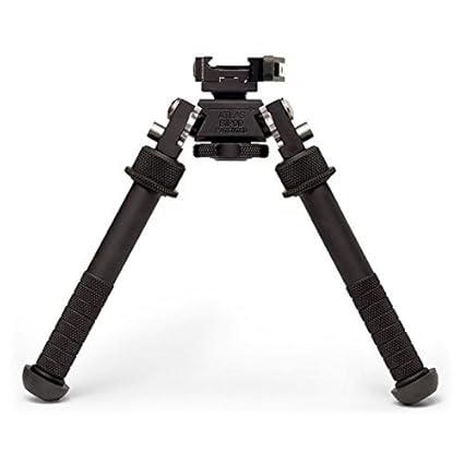

  • I use a front Atlas bipod. I tried the fancy adjustable front rest....didn't work well for me. I prolly didn't set it up right. But the bipod gives me a warm fuzzy feeling, as I'm using this for PRS style practice.

Quote: "I use a front Atlas bipod."
Honestly, there's much of your answer. Small footprint, the "feet" don't contact bench flat, and it will hop not slide. At a minimum put some flat feet on that thing. Frankly, just make a bag-rider and go back to your front rest.
Atlas bipod:
You see this bipod only touches hard surface at two tangent points on the "crowns" of those feet. NOT good for absorbing pulses or for tracking. Really bad in fact.
What's the rifle?
Have someone video you shooting. There's probably a little hop. On some shots. Honestly, nobody shoots benchrest (or event F-TR) with a bipod like that for many good reasons.

I know you are right about the bi pod. Still... may be weirdly.. that's where I want to push myself in my shooting... I'm not looking for true F class equipment. I want to work on my mental game and the bi pod forces me to do that.
Is that weird? Or illogical? Honest question.... cuz if I can master the bipod here, it helps me in the more fluid PRS type setting... is what Im thinking.
I think the bipod feet are an excellent idea.... thx. I think the "ski" type feet might work best for "tracking" I'll try that. Thx. In fact... the more I think about it, the more sense it makes.... the benches are indoor, topped with carpet.
@dmoran ... I know yer right. :) I have won several matches in this group and often place 2nd and 3rd.. .. so I am competitive but I am likely handicapping myself.
OK, if your bench is topped with carpet right now, the stock Atlas feet can sink into the carpet a bit which will absorb some of the hop. That's good. I was assuming you were shooting off a typical concrete bench top. But you will still benefit from a wider bipod base and feet with more surface area.

Update: ordered new scope Sightron S3 8.5 - 32x56mm 30 mm tube with 1/8 min target dot. Its a bit more "F-class" than the Athlon Ares ETR.. which has a tiny floating dot that's hard to see in low light, and "in the black."
Also ordered the Atlas "ski feet" that will allow the bipod to "track" a bit more on the indoor carpeted bench top. The other rubber feet had alot of "give" in them and weren't as stable as needed.
Next match: Monday.
Got the ski feet which will both give a solid verticle platform *and* will rotate / articulate horizontally for something akin to a f-class front rest. Better tha the soft rubber feet that were on there anyway....
