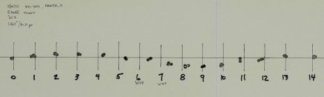

Based on this test target, how many marks would you move at a time to get rid of the vertical in group 11? Each number on the target represents one mark, fwiw. Also, 10 was a repeatable sweet spot.

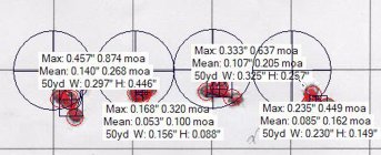

Because I've spent the last 15 years of my life doing this and not based on opinion, but actual testing and backed up by science. I strongly feel that there is a ton of bad, wrong info out there about using tuners. I back that up with science and results like the test target I just posted as support.
It's one thing to not understand something. It's another, to not understand it but to ridicule actual science is preposterous and a huge injustice to ALL of us...from the newbie to the multi-time national champs.
The target above makes my case. It's not a fluke. They virtually ALL show similar results as that one. I only use that test as an example(fired by customers) because it's a light bulb moment to anyone that does it. All of a sudden, it all makes sense, rather than randomly moving a tuner hoping for something predictable to happen. That test quantifies the value of each adjustment, on the target.
Calling something a "method" implies a methodology and should yield predictable results. Doing something randomly, or with no known predications or at least expected results from it is why so many people chase their tail and just pick a spot and hope for the best. I will say that if you don't know WHY you're moving a tuner, you probably are better off not touching it. But that target above is easy and it shows you WHY, WHEN, HOW FAR and WHICH DIRECTION to move your tuner.
I'll end with a question. If you don't have a confident answer, you're very likely chasing your tail with a tuner....
WHY do you choose whatever increment you use, when setting your tuner?

But I'm not arguing. I'm truly trying to help people learn a methodical tuning method. I stated science and asked a question is all. A couple decided to ridicule science. Why, I don't know.
As to your test target, send them to me if you have them. It's so predictable that you may be in a 1 percentile range or less, where it doesn't work but based on that, I think we can figure it out. The sine is less apparent at 50 yards but the group shapes are always there. Anything is possible but I'd like to work with you on it. Keep in mind, you have to start by quantifying the value of each adjustment with YOUR tuner. So seeing the patterns seen on my test target may not be at the same intervals. I've done the leg work on mine and several but Jerry came out with his tuner after my last vibration analysis test.

First thing I'd do is to establish how far you have to move YOUR tuner to get straight vertical. That may be 1/2 mark or maybe 3 or 4 full marks. Establish that, and I think we can get somewhere with your gun and tuner. Am I wrong in saying that you need to know the value of each adjustment or else you are guessing? Seriously.. So, I'd start with that. How far in .0005 increments from perfect tune to straight vertical.
