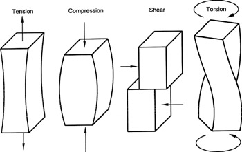

if it flexes, the screws are going to be in shear, not tension, at least in every scope base i've ever seen.
school me on this. whats the difference between shear and tension?
A link you may find interesting:
http://www.arp-bolts.com/p/technical.php......hit on Common Failures....excellent pics and explanation of the above. Syncrowave's great sketches in photos.
