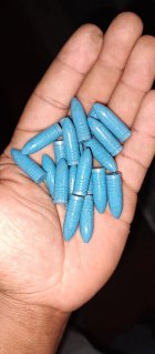

Doing a little experimenting tonight. Was told you could get some neat color schemes by mixing some powder coats so mixed some Carolina Blue and some jet black. Also baked them with my toaster oven air fryer feature and well dang tings are almost too pretty to shoot lol ! :D
Great looking bullets before and after PC.

Beautiful job Wolfdog! I mixed Eastwood sea foam green and gloss black for these bullets. 350 grain 45/70 on the left and 278 grain 375 on the right. Cast using Accurate Molds. When I first started messing with powder coating 10+ years ago everybody was saying leave them in the oven for 20 minutes at 400 degrees. I’ve since learned that leaving them in for 30 minutes results in a more uniform flow. I size all of my cast bullets .002 over bore so that they get their final sizing on their trip down the bore. I seem to get the best accuracy that way. Keep up the great work! Lotsa fun ain’t it?

I know you are asking wolfdog but I size both before and after PC but I guess what each gun likes determines that. Many over on castboolits use Smoke's (Smoke4320) powder coat as it has all been tested and proven to work even in shake and bake methods. Emails is smoke@paintballkingdom.com
Thank you. I forgot to address the sizing question. I size after powder coating. I have some of Smoke’s stuff and it’s top notch. I just lean towards Eastwood cause they’re about a 40 minute drive from me. They’re both excellent quality products. I just dump the bullets loose into an old Lyman tumbler and add the powder, let it do its thing for 15-20 minutes then dump into a sifter to knock off the excess powder. If you individually hand stack the bullets on the non-stick aluminum foil like I do don’t forget the nitrile gloves. Very important.

So honestly I have really sat down and measure many bullets at all as far as diameter goes. I have to cheap igauging calipers so honestly I'm not sure how precise I could be, think that's more where you want a micrometer. As far as sizing I size before and after PC. Mainly because it seems when I gas check before coating my bullets are more accurate,best I can guess is a coated bullets has more variation and won't let the gas check sit just right and since the butt is what steers the bullet .... One being a little cocked to the left one to the right ect due to differences in PC thickness on the base could definitely cause problems. Also they can just be a pain to get the checks to go on. Noise all this when I started casting with .223 and .22 hornet and just carried it on to the bigger stuff. More and more km happier I went the "hard way" by casting small stuff and trying to go higher velocity as my first casting experience.
As far as size to bore , honestly I'm usually going .002 over instead of one . From all the reding I've done the guys who get the best accuracy are usually going bigger then "normal" that being said I used the NOE sizing system so I can go very incrementally. The sizing bushings for their sizer are like $7 a pop so I'll have everything from say .313-.316 and just size batch's in .001 incriminates and just see what works.

Found out running the air fryer feature on my oven for the first five or so minutes to where the pain starts to flow and shine then dropping it down to 350-375 for 25-30 min is key to t pretty look :cool:
Beautiful bullets ! Especially like the 375's one of these days I'll get around to going to the big meplats but right now just something about them just don't sit great with me lol
