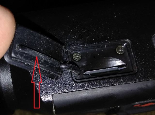

There are two rubber covers on the right side of the scope. One covers the USB/Charging port, the other the SD card slot. The cover for the SD card has a piece that would protrude into the empty SD card slot, but with a SD card in there, the cover doesn't close far enough and will pop open. Try pressing it closed.... ejects the SD card. :( Picture with red arrow.

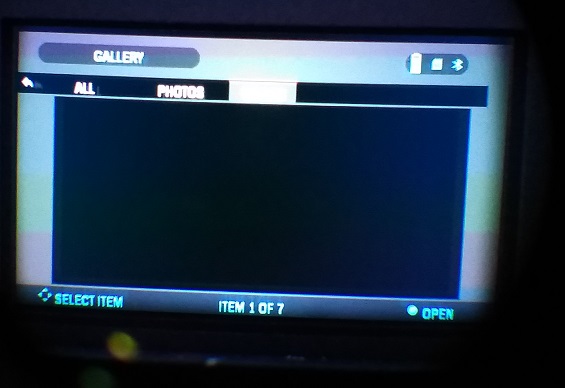

When trying to view the videos through the view screen, you can't see what you are looking at. At the bottom you'll see 1/7, but you can't see the thumbnail of the video like you should be able to.
