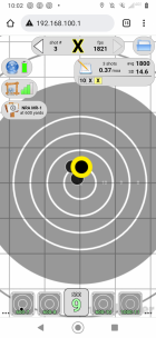

Btw, I shoot the Hornady 140 gr ELD-Ms in my 6.5 Creedmoor RPR and have had very good success using Hodgdon Superformance powder. Might be worth a try. It's not listed even close to RL 16 but I've been getting some good accuracy with it out to 1000 yards, some sub .5 MOA groups. It's not a barn burner but it is producing some good accurate groups. Here's some 600 yard test group shooting.Screenshot_20220226-100224.png
