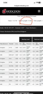

ADI whom produce a good # of Hodgdon powders list some hotter 357M loads:
Their equivalent chart can guide you on what you have or can get locally:

I'm running a max load of H110 behind a 158 gr XTP out of a Henry Big Boy carbine. That combination gives me 1,710 fps. I would feel that it would just just fine for shooting paper at 200 yards. This load is my accuracy node and at 50 yards, it's cutting holes.
