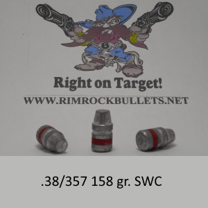

Hi all. I am interested in playing around with this bullet for 38spl and/or 357mag
I have an S&W 686 Competitor to run either case.
I can not find any actual load data for it that bullet. I also have some plain lead 158gr SWC bullets for comparison.
I am interested in a load ending up around 1000fps. Maybe 1100. I am working mostly with AA#5. I made up some rounds with each type bullet last night using 8.6gr of AA#5 which is about in the middle of the AA#5 load data for 158gr LSWC bullet in .357 cases. Here is my concern. The HP bullet is a bit longer from the crimp canellure to the base than the LSWC bullet. The volume in the loaded case will be less. Do I have to worry about overpressure? I have a chrono so I can measure actual speed but no way to measure pressure.
It would be nice to find some actual load data with the LSWCHP bullet.

I am worried about over-pressure due to the length from the crimp-groove to the gas check. It is longer than any other bullets I have load data for.
Just start low on the powder charge and work up slowly looking for pressure signs. If you are looking for expansion from that bullet you may be disappointed.
John
well at this point I don't have a way to test for expansion anyway so I have to go by velocity and whatever other expansion results are out there. That lean SWCHP is not much of an expander? I though it was the type used for the so-called FBI load with good expansion over 900 FPS
I run the rimrock 158 gr lswchp gc in a mod 15 S&W 38spl 4in barrel with hs-6 @ 925fps expansion from this soft swaged HP is impressive no need to push this bullet past 1,100 fps in your 357 for a self defense load, your accurate #5 will work fine. On your load work up use a crony to verify your vel.
