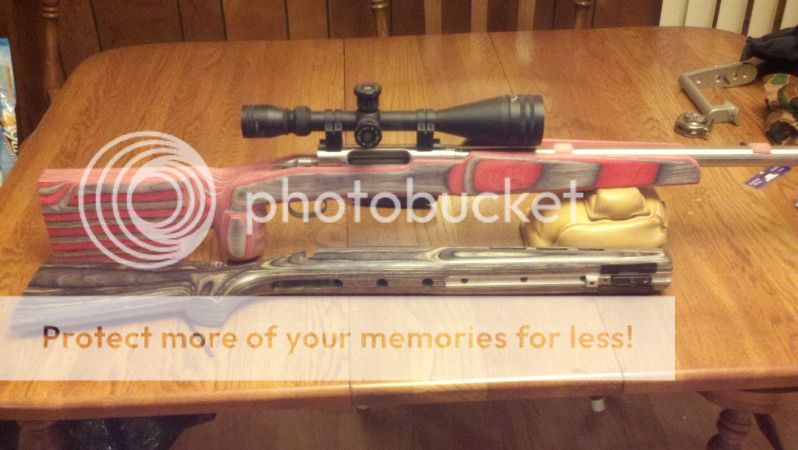

I am making my own stock and have it finished except the cheek area and buttpad. Thinking of making a snap on/off cheekpiece using magnets and a simple raised buttplate. Since I can still sand and fit, why not "make it fit" instead of adjustable. Save some weight on hardware as well.
Thoughts??
I still have some work in the grip area and still have to mill the vent slots in the front.

I allready had the vent holes drilled when someone pointed out they may weaken the fore end. I left the rib kinda high for that reason and I liked the look..
Here it is with a coat of sealer..
That stock you made looks good to me.I wish I had that kind of talent.How does it feel in the bags?What kind of scope is that out of curiosity?
The scope is an old Tasco World Class 10-40 that I have had for years. I put it on for all the mocking up in the stock. It has actually been a VERY reliable scope.
Not had it in the bags yet because I dont have the Bag yet!! Going to use a Gator with 3/4" wide ear and a Centershot front bipod. I am holding off on ordering the Nightforce till I can hear some reviews on their new comp model.
Starting to get excited about shooting this one!
