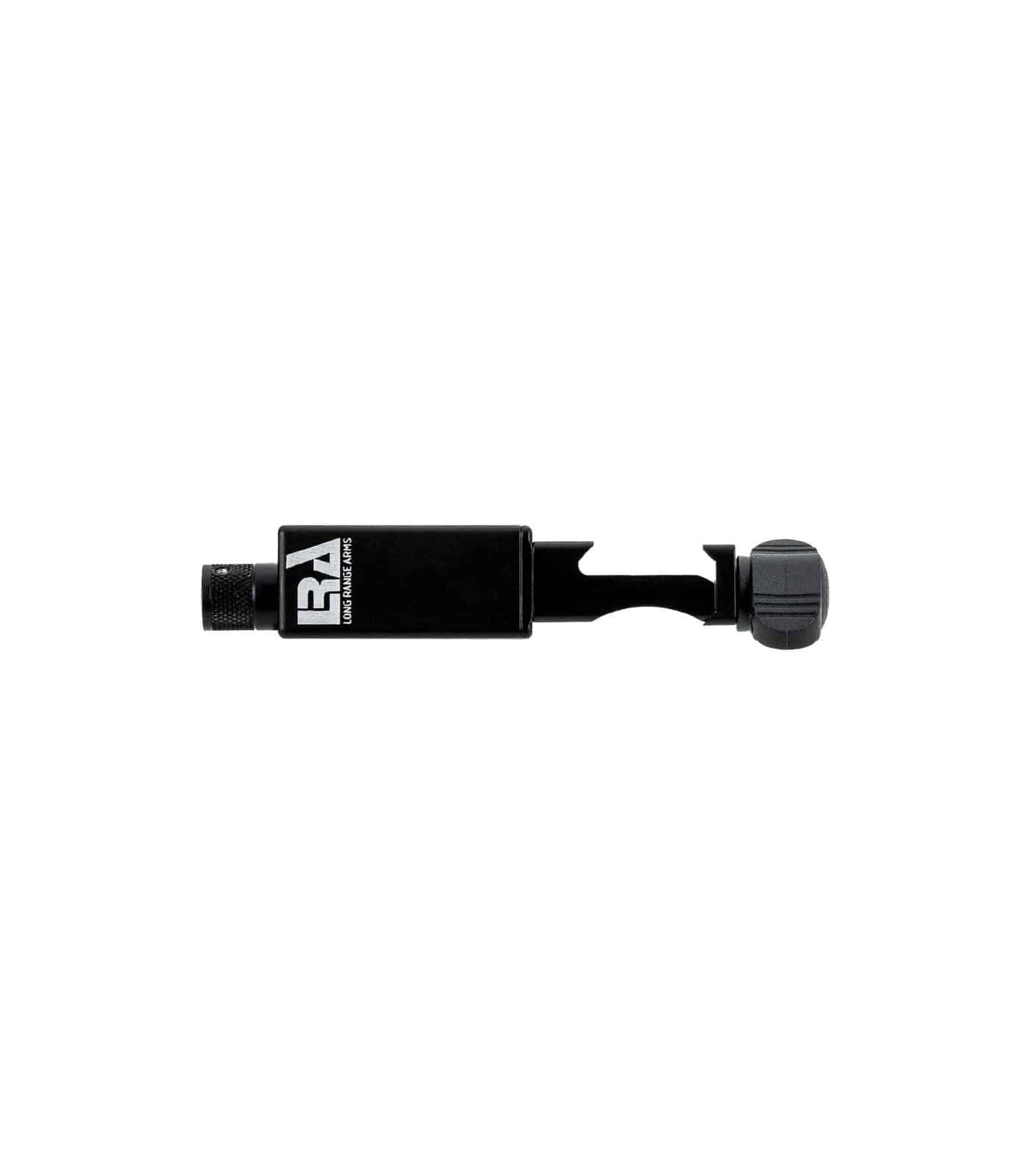

Action rail mounted bubble level
That item looks to be a scope leveling kit along the same lines as the Wheeler kit. Not sure how you adjust (zero) the pic rail-mounted level part. It might work though. There are others along the same design that mount to the rail instead of the more common design of wrapping around scope tube. Pic rails are very inconsistent so you'll need a way to adjust the level.
Spuhr makes a bubble level that mounts on their scope mounts. It is very nice, visibility-wise for your alternate eye. It is adjustable for zero. Downsides are 1) high price 2) it protrudes out away from the scope so you have be careful of crashing it. You cannot reverse it and have it hang over the center of the scope.

Sir, if you search for " anti cant bubble rail mounted", you will find several options including the ones from us optics.
Don't get a rail mounted level. Get one that is mounted to the scope body and ensure its level with your reticle. You'll be able to see it from position, and it can go with the scope and remain level no matter where you mount that scope.
Rail mounted levels are hard to see and require you to break position. I like the Accuracy 1st level.
US OPTICS Anti-cant
Added;
a 300wsm does not break up the bubble into many smaller bubbles, as the less expensive levels do.
This is the one I use. Like Dusty mentioned, it is relatively simple to mount behind the rear scope ring (i.e. at the end of the rail nearest your face). They are a little more pricey than some other mounts, but I have them on all my rifles and have been very happy with the performance. Just be aware as with many of the rail-mounted anti-cant devices, that the bubble may not be perfectly centered after the top of the rail has been leveled and the device mounted on it. If not, it is pretty simple to use a shim of some sort to center the bubble. I use a small folded piece of aluminum foil under one side or the other. I can fold it to whatever thickness is required to center the bubble.
